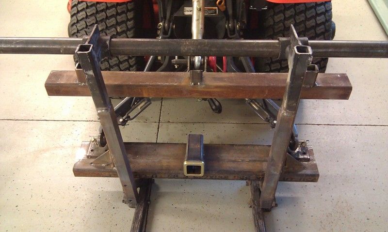

This isn't 100% finished yet but I've always been thinking about making a set of rear forks because of the weight limit restriction the front has. I was just about to make another pair of forks when I thought, why don't I just use the front forks for the back. So I looked through my scrap pile and threw this together.
Took a little bit to figure out the placement of the top connector to make sure that when it raises, it stays level.
Now since the forks stand up on their own, I can just back right into them and pick them up.
The extra angle iron welded onto the forks was just done after making the rear hitch. That was because the forks had a hold drilled through them about half way up from my first attempt at making a 3pt fork setup. I scraped that idea and turned the rear forks into the front setup which has worked great. The holes never gave me any problems even when I abused them, but the rear has 2x the lifting capacity that the front does, so I was worried they might be the weak link. So I beefed them up.
