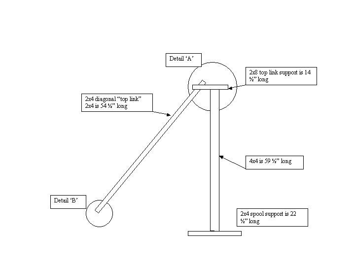

The top pivot was the hardest to make. It's a 2x8x12 with a 9/16 hole through the center of its 2 inch dimension.
I'll get the measurements of all the pieces tonight and post them.

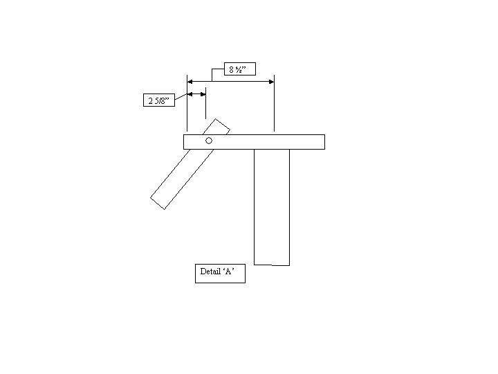

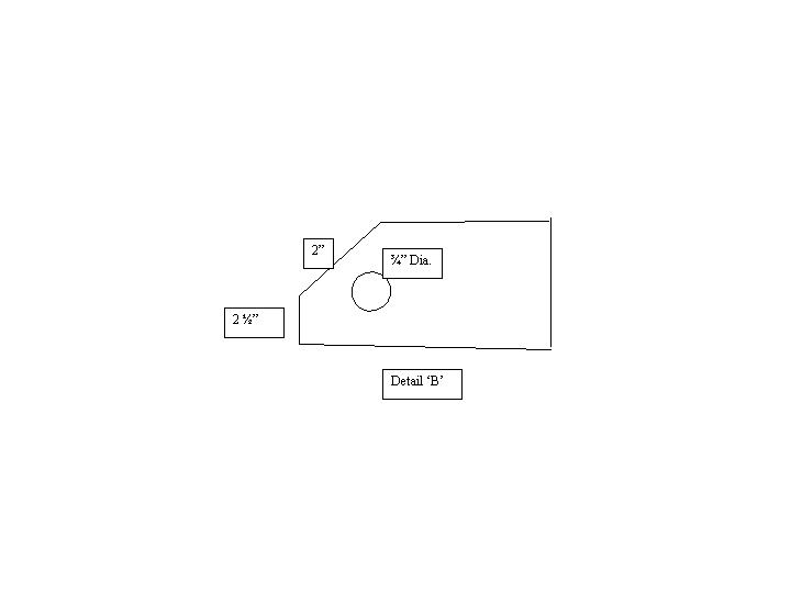

At last I was able to measure the components of the fencing tool.
Attached, is a file that has a schematic and general dimensions. Please note that all joints are able to pivot. The 4x4 spool axle has a 6" lag bolt in each end so it and the 2x4 support can pivot. These tend to unscrew after a while so keep a socket wrench nearby.
There are 3 files that hold the schematics.

   / Field Fence Installation Tool
This is one of the two details.
This is the second detail.
