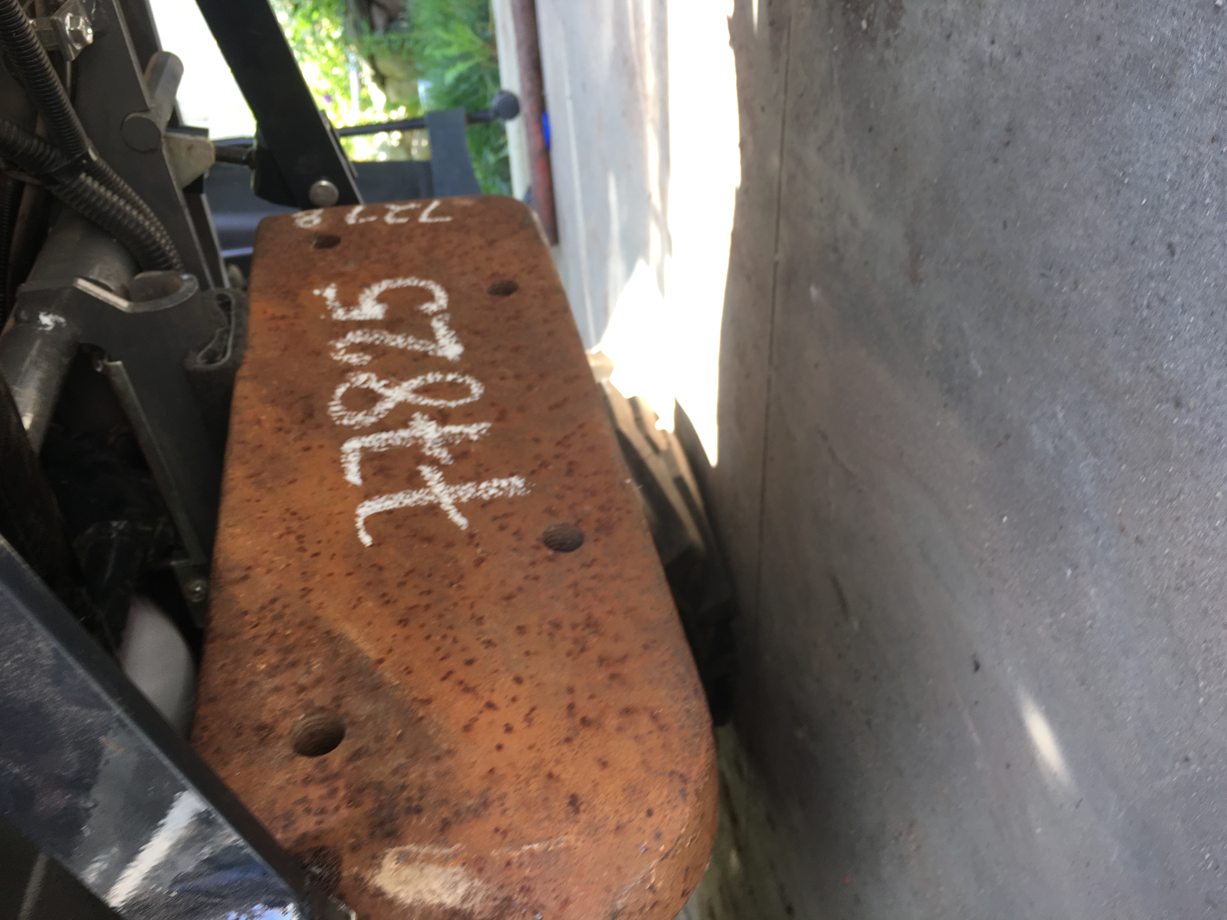

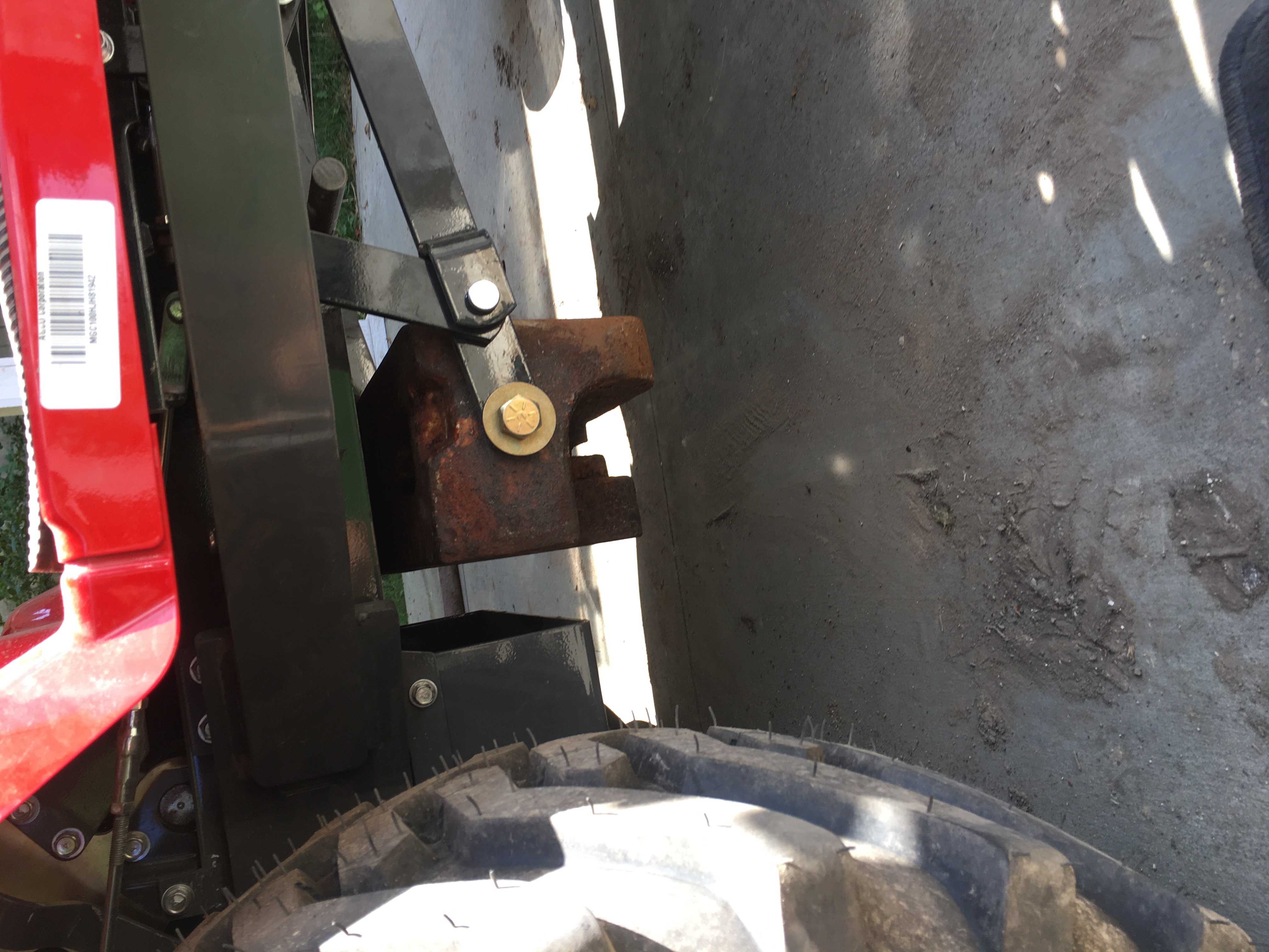

I bought some 125 lb weights at an auction I was going to use for rear ballast when I take the hoe off. My tractor spends most of it's days in the woods and no matter how careful I am I have had a few very small twigs hit the cooling fan on the Hydraulic unit. Long story short I figured out my "Oliver Starter Weights" were the same width as my mower lift arms, so I killed two birds with one stone.....added 125lbs of ballast low and near the rear and blocked twigs from my cooling fan....
If anyone has driven a TLB just off camber you know the pucker factor...I can attest that adding 125lbs lower and centered has allowed me to relax a bit. Also I can lower the weight to drop it or change the filter as needed. I also don't have a mower nor will I ever for this tractor so that is a non issue.

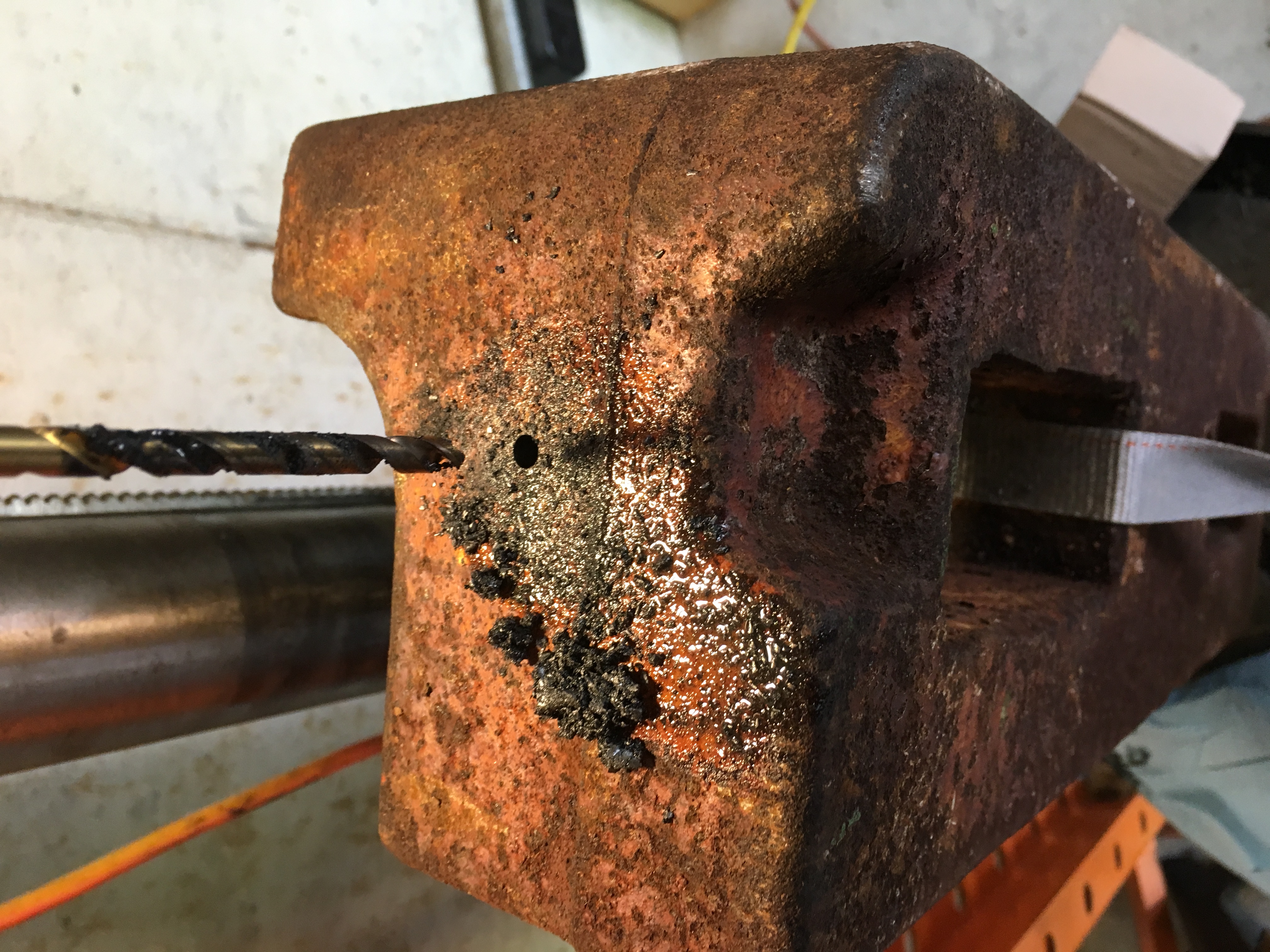

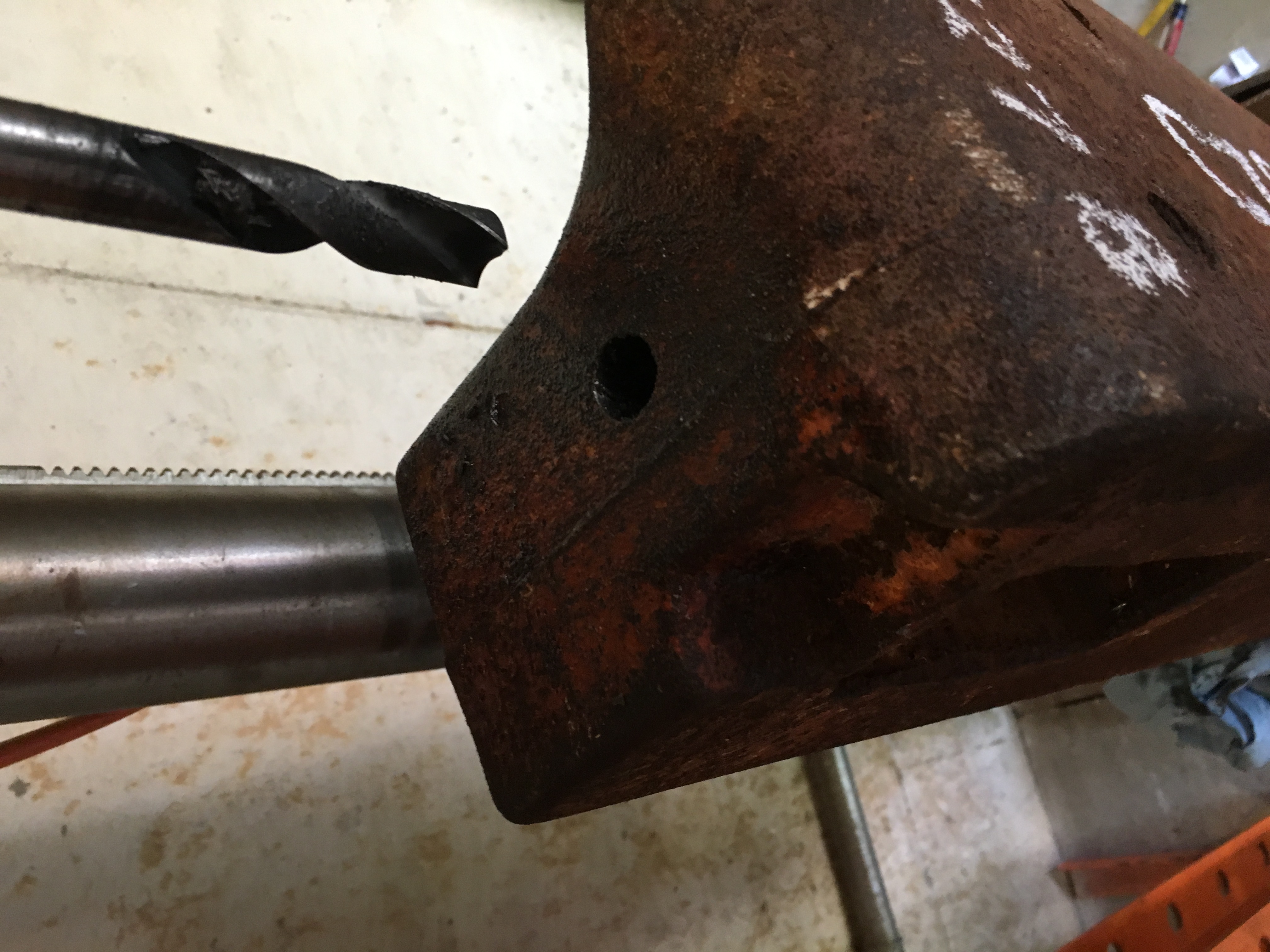

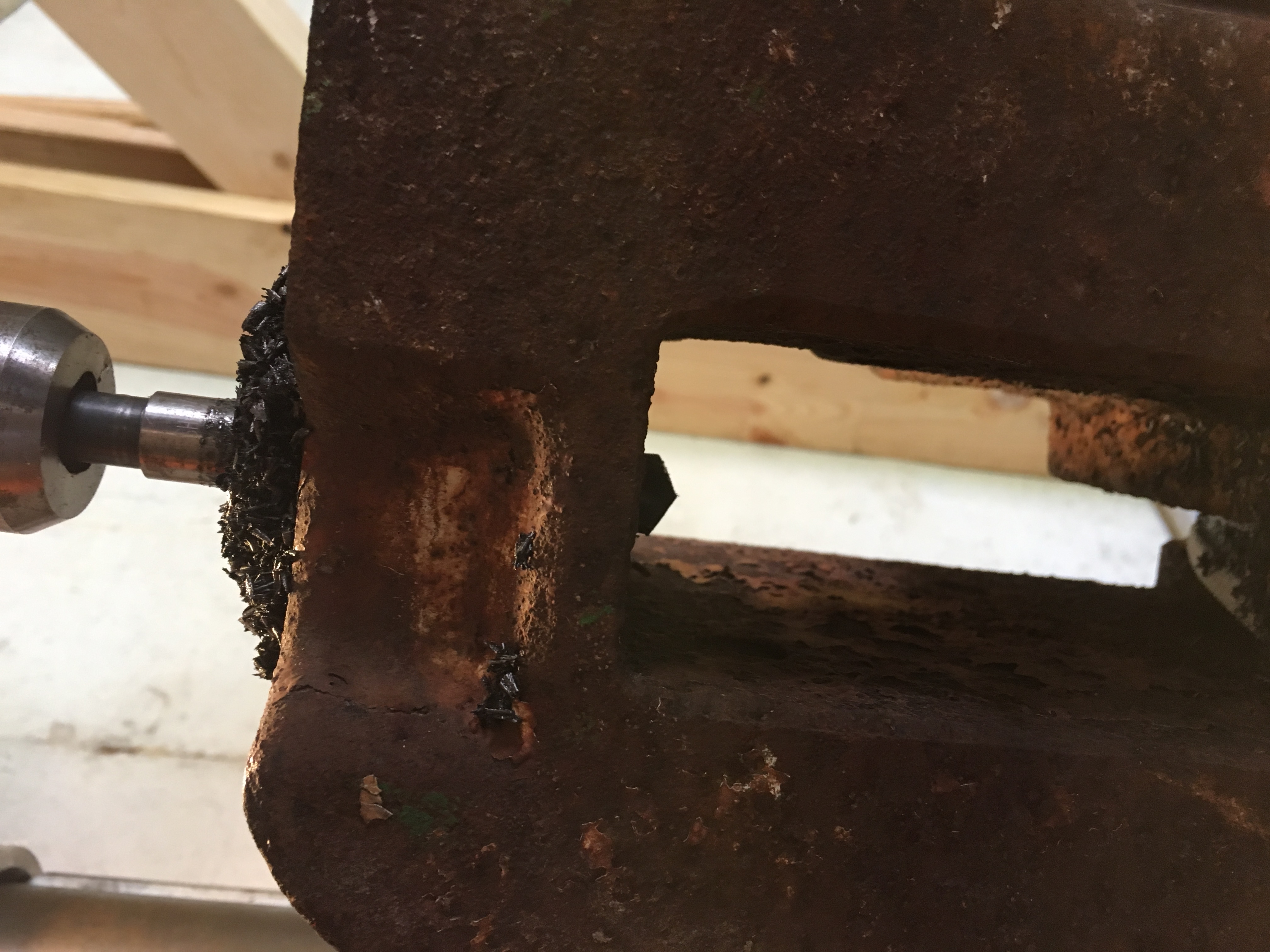

If anyone is interested find an "Oliver starter weight" at auction...they are 20" wide and 125 lbs....not messing around for sure. Just had to drill some 5/8 holes and the iron was very soft so it was pretty easy. Having the ability to quickly drop it for filter change is also very nice....

Bro tek makes under body armor forthegc1700s to protect the whole under area and still be tucked up tight to the frame.
In addition, while the weight underneath can work while you have the backhoe on. . You've already got plenty of weight with the hoe. But when the hoe is off, 125 lbs. Centered in front of the rear wheels is not very much compared to having 200 lbs behind the rear wheels.

You may find it easier to just pick up a square of expanded mesh, shape it to fit and secure it with some bolts or wingnuts.

I actually did it more for weight then for protection. The 125 pounds low and centered towards the rear really helps for off chamber times, and pulling ground engaging 3 point implements.
   / Figured I'd use the mower arms to block crap hitting my cooling fan...GC17xx #7
That makes sense. Do you have your rear tires loaded too?
