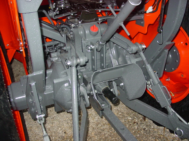

Hey, all:
I have an M4700 Tractor.
I'm sure this is a stupid question, but can anyone provide the P/N for the rear Hydraulic Fill Cap?
(Perfect Picture from another thread: DSC04799_zps81ee44fc.jpg
(I have been through dozens of IPBs and cannot find *any* reference to it!)
Thanks in advance!
Paul DeLisle
Salado, TX
   / Fill Cap? #2
KPN: 38240-21410 under K-PAD: T10200 HYDRAULIC CYLINDER
Might I also suggest a new O-Ring:
KPN: 04811-50300
   / Fill Cap?
Thanks, man...Apparently (as I suspected) I just wasn't looking in the right place!
