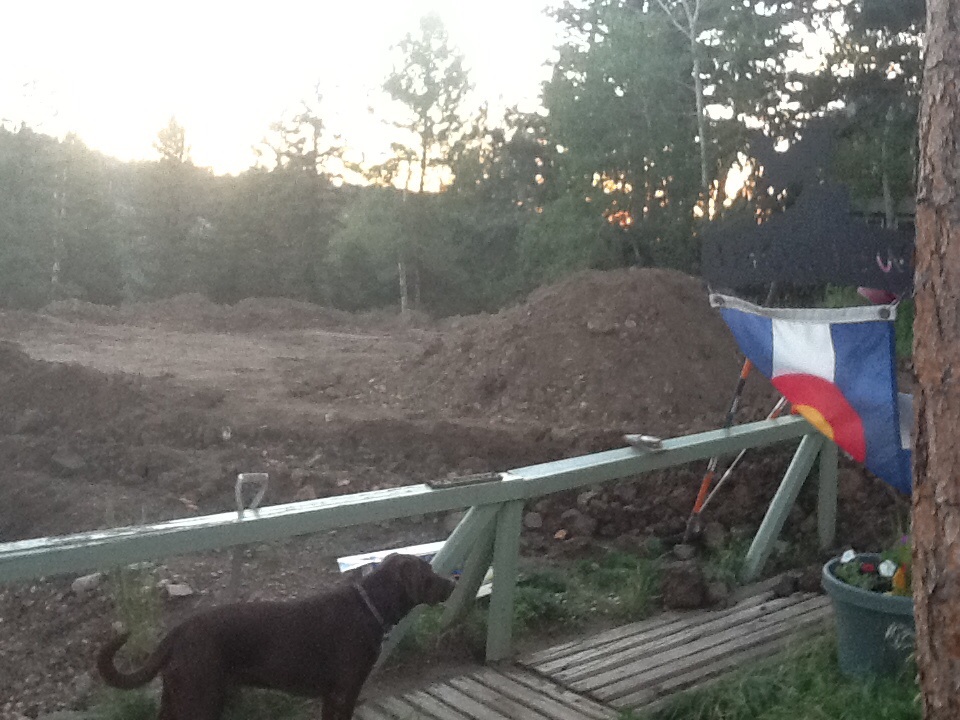

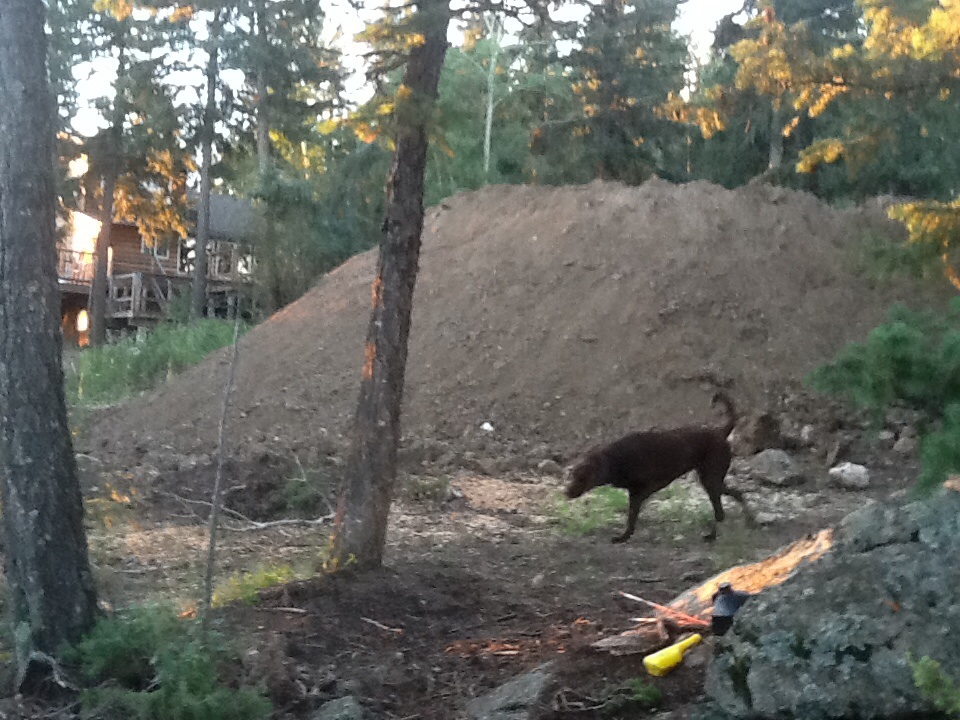

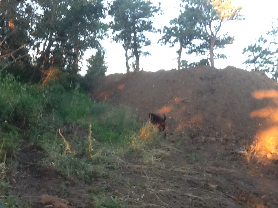

image.jpgimage.jpgimage.jpgIt was good to see your post regarding fill dirt. I live on a mountain at 8,000 feet outside of Denver. To get fill dirt up here is impossible. I have a 60' wide sloping area that drops about 15' from the top side of the area I want to build a garage or pole barn with concrete flooring. A trucking co. Contacted me this week and out of the blue I now have 640 tons of clean fill dirt mixed with clay that now flattens out the side of the mountain. I know there are a lot of red flags going up and I am now staring down a huge amount of work with 15' high fill dirt walls on the low side. At this point I'm thinking the next thing to do is contact an excavation company to come out and assess what to do next. Or should I contact a builder or the county for the next step?

If you intend to build, pour a slab, on that area it needs to be compacted correctly. Would it be vulnerable to sliding down the hillside and need some sort of retaining wall or other stabilization?
I would ask around for a good excavation company, have them visit and depending on what they say, you may need some engineering help, or it may be fairly simple. You need an experienced eye to steer you in the right direction.
   / fill dirt and surface preparation #9
Thanks for your advice, I will contact a good excavation contractor Monday. Not planning to build for two years so hopefully settling will be ok once the dirt is moved and positioned for a foundation. I'm just glad to finally bring my fifthwheel and trailers home.
