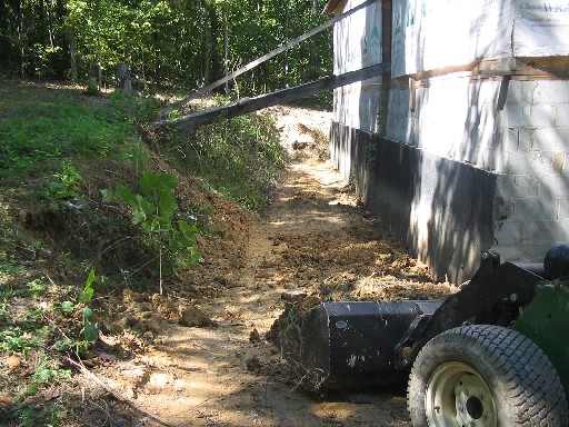

I don’t know what is considered light material but the 422 seems to handle a full load of dirt in the light material bucket. The box blade does a very good job as well. It is really handy being able to tweak the tilt at will and with ease. I Will have some pics of that later.

I know I have lifted a 10 cu. ft. very full bucket of 2a many times. I'm sure this over stresses a 422 or 425..

The 10cu bucket does work fine as an all around tool on the 425, however do be prepared for some rather interesting ( and possibly dangerous) situations when moving wet clay or fine gravel. I wish I'd have some pictures to illustrate this, but a camera is not the first thing to enter the mind while wishing that the bucket would drop alot faster thean it does. /forums/images/graemlins/shocked.gif

Yes I can recall one time when putting a full load of dirt into a ditch the tractor got rather tipsy. For a moment I thought it might flip head first over into the ditch. Now I start empting while the bucket will hit the side of the trench to be filled. A very good point you made. Thanks for bring it out.

These are powerful little beasts. It depends on the density of the material as to how full you can fill the large bucket. For example, I can fill the large bucket with crushed limestone and have few problems tipping. However, fill it with moon dust, which is granulated limestone(same stuff, just crushed much finer) and I can hardly lift it and keep the rear on the ground.
Also, we have fine black muck soil on our property. I can lift that stuff dry all day, but if it is wet, I can forget about it. It is like a sponge and soaks up a lot of water, which weighs quite a bit.
Here's a good experiment... fill your 10 cubic foot bucket to the brim with water. Water weighs about 62 pounds per qubic foot. So, you should have a little over 600 pounds in there. See if you can lift it... if you can, only lift it about 4 inches off the ground. Then turn your tractor steering wheel all the way to the right or left. Experience the PT pucker yet? /forums/images/graemlins/shocked.gif
