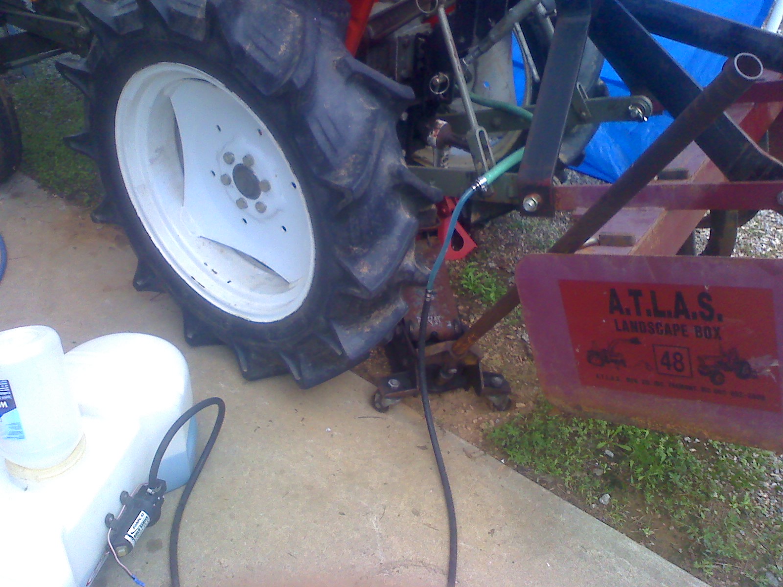

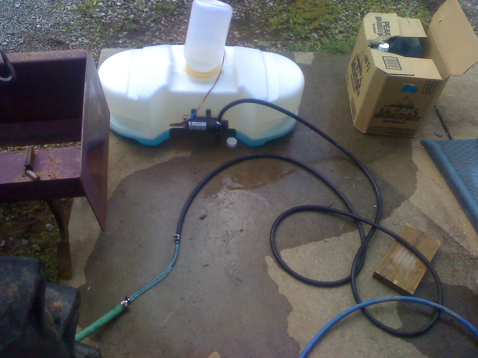

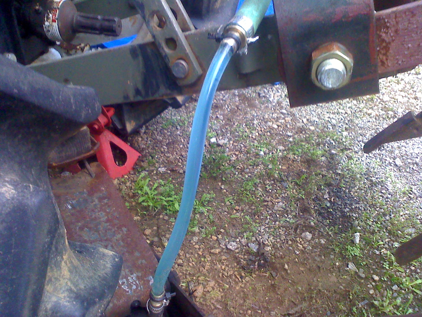

Yep i got pics of the adapters i used to attach to the sprayer to the garden hose, but i just went to the plumbing fitting section and bought 2 adapters i needed for about $1.50 each.
Go the washer fluid route. I looked up methonol on ebay and it was going to be more expensive i think plus i did not find a chart (quick search) to mix how much methonol to water for X freeze protection. I got -20F washer fluid. Put 15 gals each tire then put about 2 gallons of water in them each to fill up. Im sure i still have at least around 0F protection but not sure.
I did not post the pics of the adapters. Im still at work and its a hassle here to get pics off my cell on to a PC. I will try and remember to do it in a few hours when i get home. If you want them now you can PM me your cell # if you can get Picture texts and i will gladly send them to your phone. This is if your going to go buy the stuff now and need a visual clue as to where to go.
   / Filling tire w water and methanol #5
You can see the black 3/8 hose on my sprayer attached to a brass fitting adapter to adapt it to 1/2 hose. Then a foot of clear vinyl hose, then another 1/2 to 5/8 brass adapter, then a short 3ft or so section of garden hose, then on the end of that is the adapter i bought from tractor supply co, to adapt to the valve stem. It worked perfectly and in about 15 mins i had each tire filled. Dont forget to stop every so often and release the air in the tire that builds up. It may burn out your pump as you have to pump harder as the air pressure builds up. I stoped every 3-4 gallons probably and released most of the air pressure and continued.
