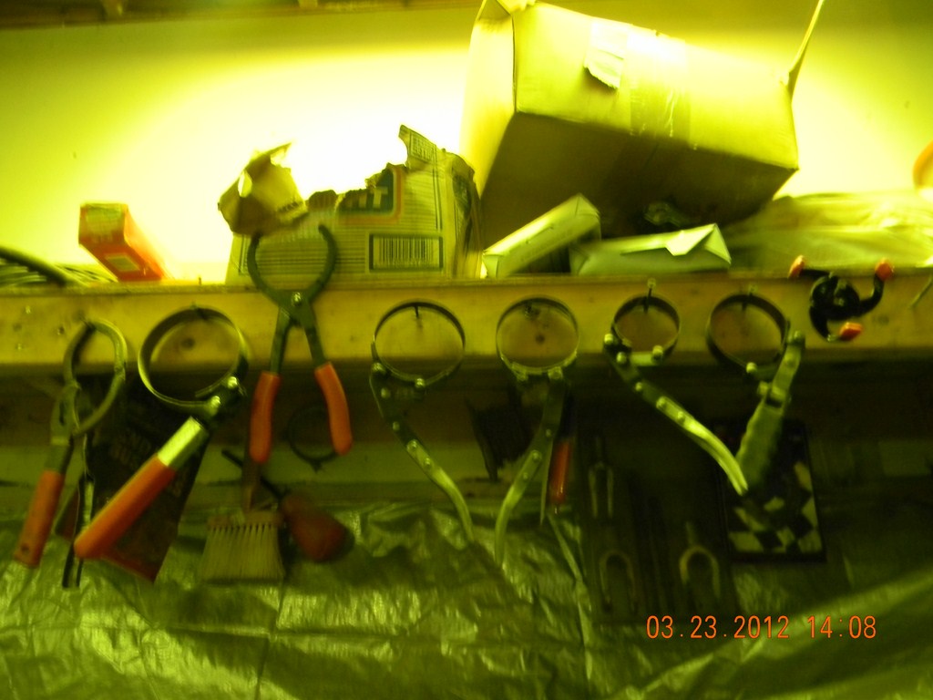

I have 8 filter wrenches of various types and sizes. If they don't work you can always drive a long heavy duty screwdriver thru the top of the filter (not by the base or gasket end) and turn it off. A bit messy but it does work.

Thanks guys. I also have a drawer full of different type filter wrenches. The spanner pliers type with orange handles has been my best to date if there is room to use it but the NAPA strap with the 1/2" drive looks even better if there is one the right size. Pierced with a screw driver is still my fall back but hope it doesn't come to that. Don't think a torch will be needed. Since this seems pretty common on the first filter change with new vehicles too, I wonder if it's because they are installed with no lube on the gasket when the engines are built. I'll get em off one way or another.Thanks again for all the ideas.
