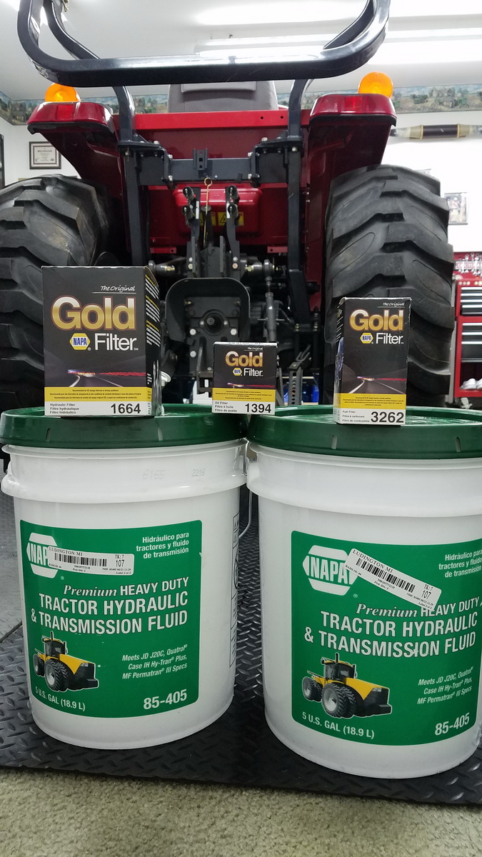

I just left the Napa Dealer and they had all the filters for my 2010 Massey 1533 and the Permalube (Napa Brand) oil for $35 less than the dealer.
Filters matched exactly:
Oil Filter: Napa Gold Series 1394
Fuel Filter: Gold Series 3262
Trans filter: Gold Series 1664
I had to get the Hydro Filter at the dealer and it was $70 AGCO Part # 6241072M1
