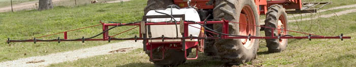

Mt Fimco works fine on a Speeco hitch. You may have to drill two holes.
An XR Teejet size 2 (yellow) is a good overall herbicide spray tip. Get a Teejet catalog and read it. Lots of good stuff.
This is a spray boom I made for my sprayer. The spraye came with a boomless nozzle which was very very poor.
/ FIMCO Sprayer Question #12
