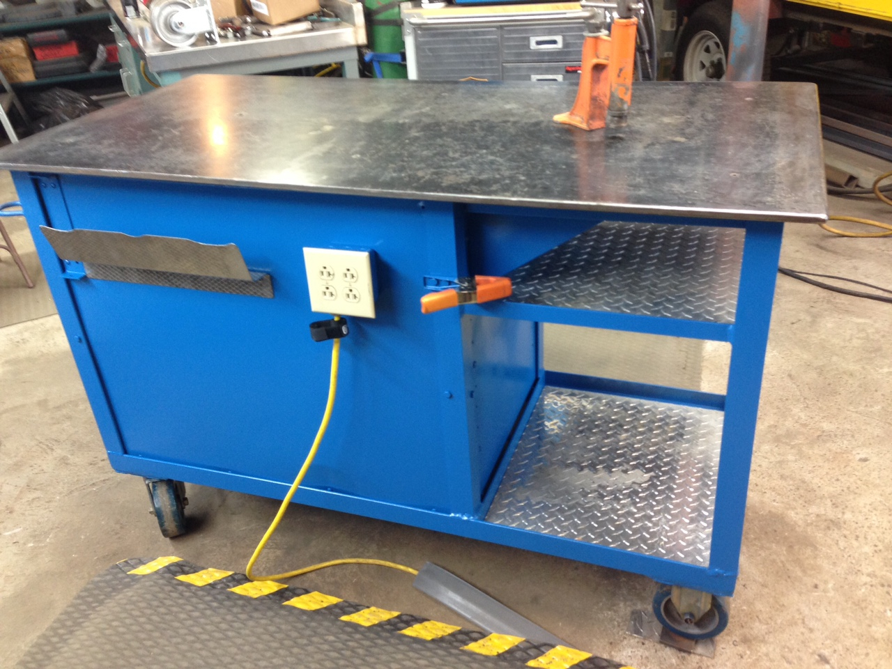

Interesting:
Some years back I purchased a 5/16" 2 x 3 ft sheer cut perfectly squared cuts.
Used old bed frame angles for legs and made lower shelf that holds my welder.
Also welded hooks to loop the cables conveniently.
Now it served me well especially when I was fabricating fireplace doors as I could clamp corners accurately @ 90 deg.
Made quite a few doors with that rig. Having a decent assortment of clamps sure helped.
LOL, now days I mostly weld outside and for that I simply use a plywood topped folding table which is now well scarred showing many grinder 'parking' scars and naturally is considerably charred in places.
Designing and making your own weld table is a good practice exercise.

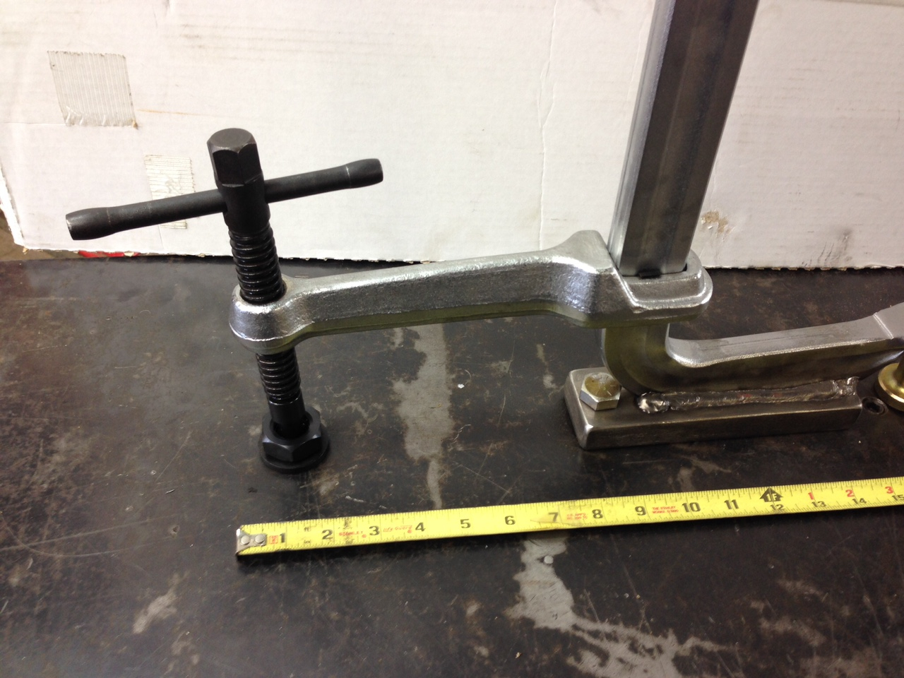

Nice welding table. Most used bench in the shop.
Drilled and tapped a grid of 5/8-11 holes for clamps and vises.
Modified C-clamp.
Use cup point set screws in unused holes.

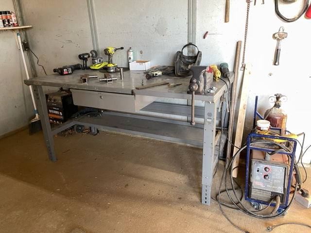

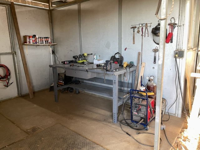

Like most you all I used saw horses, inverted trash cans, or the floor to weld on for years. I too finally got a table and more importantly a station for welding projects. This 12x12 area was a horse wash rack in the barn. Now I just need to put up some shelves, lights and wall hooks to bring it together. Found this all metal packing table on CL. Added a drawer and an old Craftsman vise.
