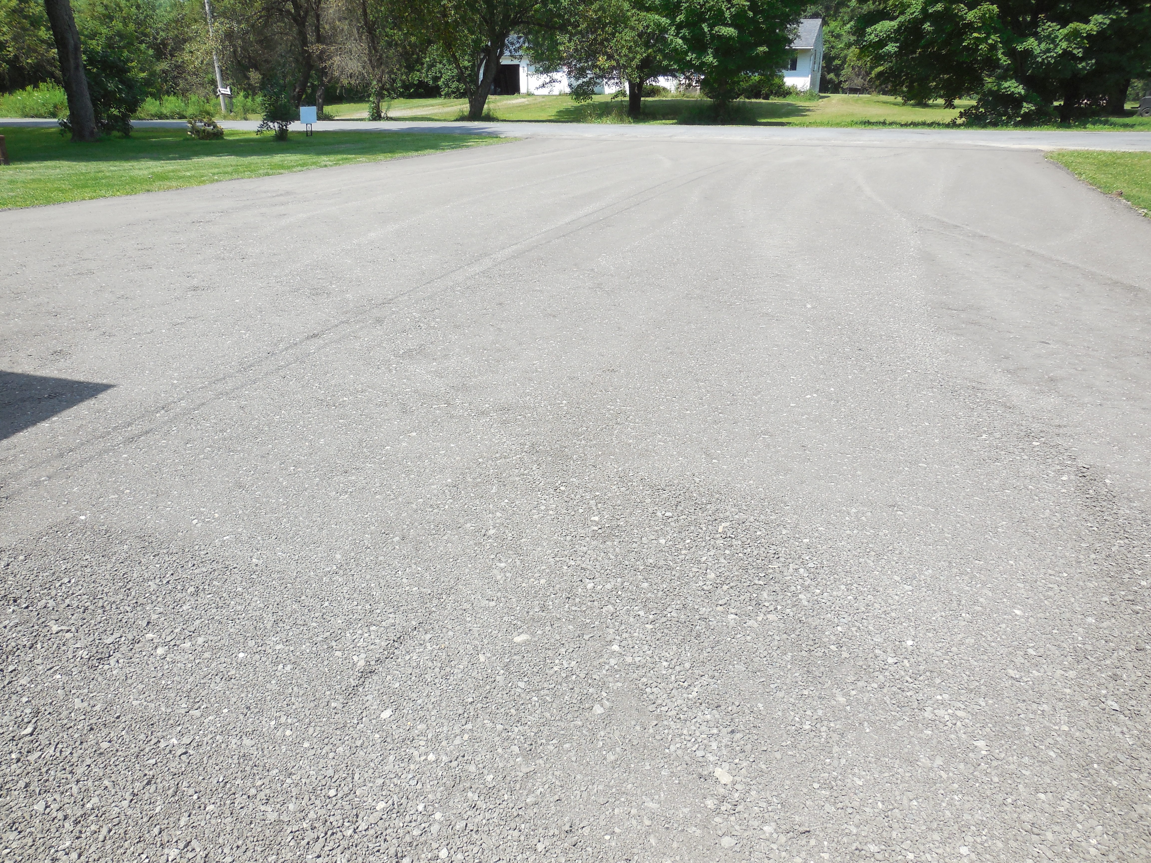

My millings will start showing up at 8am this morning. I am all dug out and ready for them. Base is hard as heck as we put it in years ago. I am shooting for 3" deep before I roll it. I will be using my loader and my box blade for the application.Today is sunny and 85 so hoping it packs hard with my roller. I am using my 1.25 ton ride on roller. I do a lot of stone driveways but this is my first millings job. I am doing my own driveway first before I dare hire out. If I am not willing to do mine I am not willing to do yours. I think 3" deep on a monster base should be enough. These are fine screened millings. Thoughts?

Driveway is done and looks great. Now I just hope it hardens up. I will roll it everyday for a few days. Hoping to put some type of sealer on it in a month or so. DSCN3650.JPGDSCN3649.JPG

Wow, that really looks great, almost like fresh asphalt job. I don't know where to get that around here, but I wonder how it compares price-wise and strength-wise to crusher-run.

Crusher run is 10 a ton here. This was screened and 16 a yard. A yard can be 2400-2800 pounds. Very comparable in price.

I put millings in myself about 5 years ago. Held up well but it will never be asphalt. You will most likely end up after a year or so with any of the fine dust or dry stuff on top. The part of my drive that was under where you drive on was like rough asphalt. The edges hard but with the loose stuff on top. I initially thought about sealing but was told it was not recommended. The fear was that it would come off in sheets.
/ Finally got some asphalt millings.. #13
Normal asphalt has oil product in it mixed throughout so that after its applied and cools off its all glued together. Asphalt is often applied over a base of compacted gravel. Applying a sealer or such to the top of a layer of gravel (which is sort of what you have) may not get the results your hoping for. Just keep in mind your only sealing and holding together the top surface and perhaps a bit deeper if it penetrates heavily. If the millings you received are sort of new and are full of oil perhaps they will adhere together better. If they are from a old dried out project then you basically have applied gravel. Keep in mind gravel drives can be reworked, that could be good or bad depending on your viewpoint. Asphalt or millings that are sticking together limits your options on smoothing it up once it starts to rut or pothole. You can patch it or have a milling machine to pop it up and reapply it.

Just watered it and rolled it again. Certainly not the end all of driveways. Right now it is like a very dense gravel. I wanted to work it wet early as today is going to be near 90 and did not want to cool it during the day. I will roll a couple of times later today. I will probably put some kind of sealer on it soon. I do not want gravel in my house. If it does not work out I will take it out and put it behind my barn and use it as a loading area. It is not as easy to work with as a nice gravel and roller shows every imperfection. Sometimes I hate that roller :)
