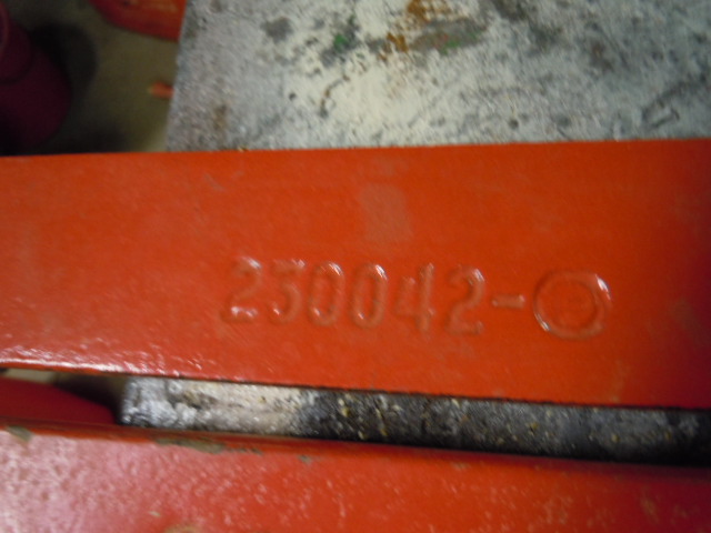

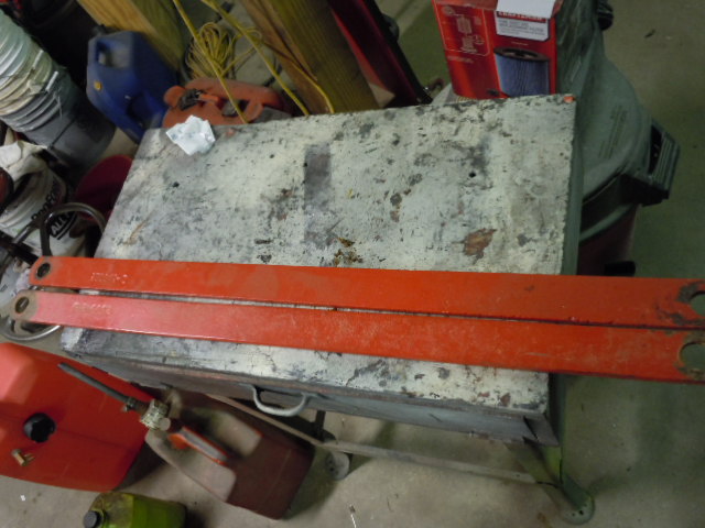

One other question I have been thinking about is how whenever I was using the rear blade it would always track as far right as the limiter chains would allow it too. Its close to the wheel but doesnt ever hit. Does it really hurt anything to have it constantly pulling off to one side like that? It bothers me for some reason so was thinking of getting/making a set of stabilizer bars for it. If I end up buying a pair would you all recommend an adjustable set like the turnbuckle style or sliding tubular style with the lynch pin? Not sure if the solid steel bar type have any drawbacks other then not being able to offset the implement some intentionally.

I use flat non adjustable steel sway bars. Some of my trails are steep and it also keeps the implement from shifting the weight from side to side when in the raised position which can get pretty hairy on slick wet steep surfaces.

The flat stabilizers work good with these old tractors. I'd try to find some OEM stabilizers as they have far better metal in them than the cheap aftermarket ones do. If you can,it's best to use one on each side to keep from bending the one stabilizer.Here's a pic of OE stabilizers with the part number stamped on them. DSCN3942.JPGDSCN3941.JPG
