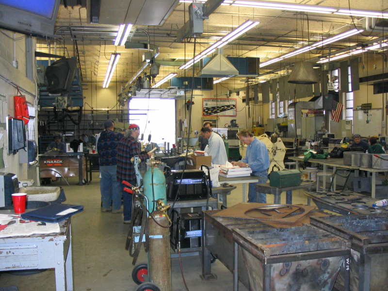

Rosey: Here in PA, they call it a Career and Technical Center. It is kind of like a CC, but much more trade oriented.
The class costs $350.00 and the shop is enormous with lots of heavy equipment. I'm going to take another one just for building 2-3 projects.
Here's a pic of one side of the shop. They have about 25 Miller welders, plazma and torch cutters, drill presses, band saws, etc. all sorts of stuff.
