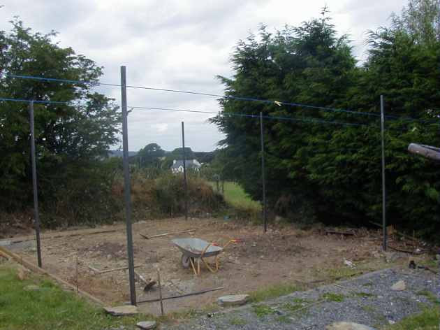

Hi Guys,
After years of planning to build a shed over numerous cups of tea it has finally entered construction phase. The workshop is going to be a complete steel structure sheeted with "kingspan" cladding. Kingspan is the main manufacturer of cladding here in Ireland. The size is 18ft by 21ft and will hopefully give myself and the brother room to build some of the projects we have in mind. Here is a picture of the site where the shed is going.

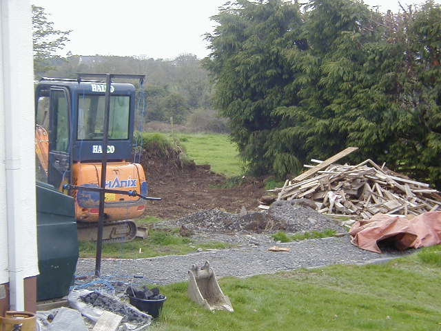

we hired a mini digger and a 6 tonne dumper to clear the site of topsoil.

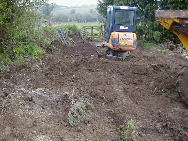

after a while playing with the new toys the site was cleared and ready to mark out.

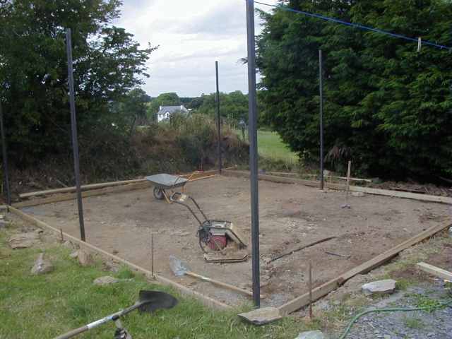

we used the uprights to run timbers against for a shutter. the base was filled with stone and a wacker plate was used to wack the **** out of the ground

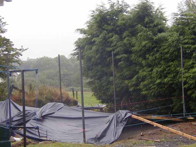

once that was ready the concrete was ordered(5 metres). It was ordered for a wednesday morning at eight. The weather in ireland had been brilliant up to and including wednesday which meant that the garden was rock hard and a concrete lorry wouldnt do too much damage. Unfortunately the concrete company cancelled on the wednesday and the weather on thursday was good in the morning and then rain was forecast for 3-4 days. We decided to take a chance and go thursday morning . if it rained we would try cover the concrete. As soon as it was in the heavens opened. typical. The concrete did get slightly pot marked but it meant that the garden wasnt tracked. never again will i do concrete in the rain

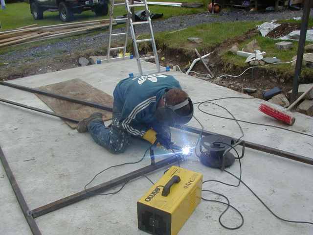

after 3-4 days the rain subsided and we started to make the roof trusses up.
