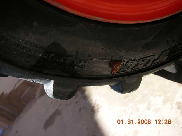

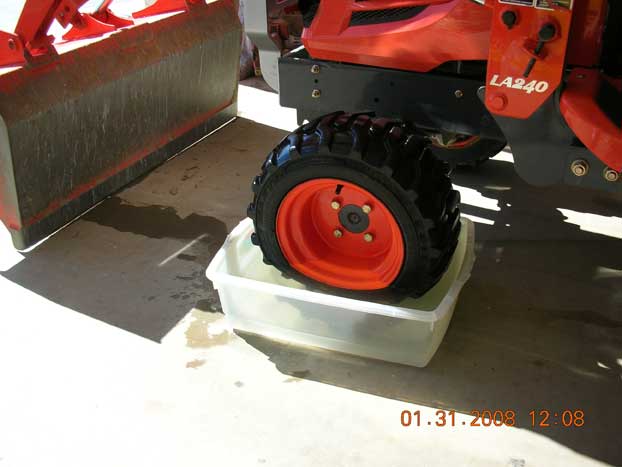

One of the front tires on my BX24 was losing about 3 psi in a 24 hour period. I tried the soap and water and did not have any luck locating the culprit. By using the loader bucket to lift the tires, I was able to slide a tub under the tire, fill it with water, and wait!! and wait!!
Finally, after about 15 minutes of searching, I found it. One small bubble every 15 seconds.
Total time 30 minutes. 10 minutes to locate the tub, 15 minutes to locate the leak, 5 minutes to plug and put in the air.
It sure was nice not having to spend the 15.00 to have the tire fixed. (and there was no real manual labor)

Now I have seen it all. A Kubota soaking it tire after a hard days labor. Next thing the hour meter will cause the engine to shut down after four hours of running time. There must be a union card in there someplace.

Plugs dont always work well in the side wall, I agree some slime or even the dreaded fixaflat might have done you better. Good luck.

I like that. Yup, after a hard day at the office, my Kubota needs a "foot" bath. Maybe even a "foot" massage! Oh, and no, the Kubota does not shut off after 4 hours of running time, I do. On second thought, I don't make it 4 hours, at least not without a nap. :rolleyes:

Actually, Slime's website says it won't fix sidewall leaks.
