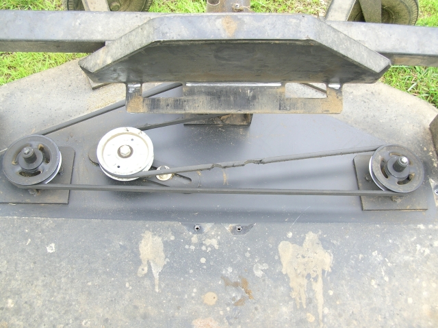

Removed the covers today on my 48" mower. You can see the bad sections on the belt. There was a load of grass and other debris under the belt before I cleaned it out with the leaf blower. There was a lot more than I expected to see! I always use the leaf blower on the whole tractor before putting her away and the grass accumulated that much anyways. I may leave the covers off from now on.

Here are 2 closer views of the bad belt sections....now these are UGLY!! The PT belt has a number A-105 on it so I picked up a 1/2" X 105" belt at TSC...too small!! Back to the store and got the 107". I think I will order the cogged belt previously suggested for the future but I need the mower quickly. I'll try it out in the morning before any 4th festivities....by the way, Happy Independence Day to ALL!
