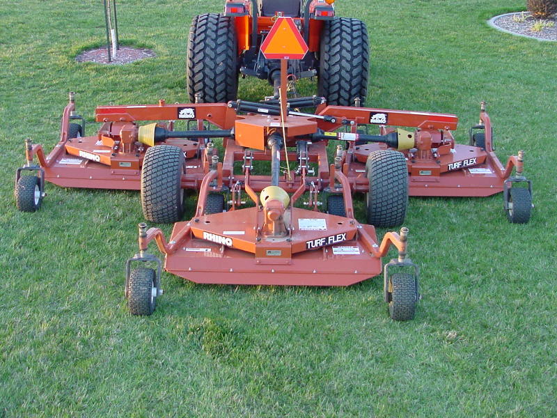

helobubba,We finish mow approx. 10-11 acres weekly through the season,I try to keep the grass in a "Park like condition" We bought our Turf-Flex last Summer and it has been a great mower soo far.I perfer this type of mower over a "Gang Type reel mower" as the reel type are a job to service.Plus, they just cut too short for my taste.
Bush Hog,Landpride,Befco,Woods and Rhino all build this type of mower.I went with the Rhino as I felt it was the best of the lot,for the price.Ours is 3-5' decks,with the overlap,it cuts about 13'5"-14'.Most of the mowers out there come in a 12' model also,not sure of your P.T.O. hp. but takes a minimum of 30 hp. to run the 12' models.

Our mower is 15',the finish cutting width is 13'5"-14'.I mow about 7 acres of our property with this mower in 2 hrs,but I go fairly slow,the mower does the best job of cutting at about 3-3 1/2 mph.I use a Kubota L-4610 to pull it.
Befco was the only other brand I would consider,they have a Cyclone Super-Flex line that is very well built and has some good features.This model was the closest one I could find that would compare to the Rhino.
The Befco dealer was 90 miles away and Rhino dealer was 40 miles,the Befco was about $3500.00 higher in price also,so for me,it was an easy choice...I have no complaints at all with the Rhino,I would buy another one tomorrow.

The Rhino Dealer I bought our mower from is located in a Rural Ag Area,very depressed market.He had been sitting on this mower for close to a year,and was ready to move it.We gave $8,500. for it. The list was around $12,500. Befco Dealer was asking 12 grand for their unit.
It is a Turf Flex TX135.
