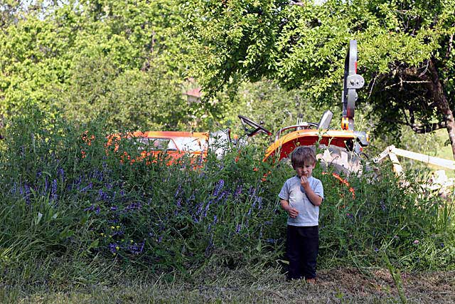

If its never been cut, I agree that a brush mower is better, it will help you find all the hidden obstacles and hopefully not hurt the mower in the process. If that is not the case, I'll post pictures tommorrow of just what my 84" finish mower can cut. My brush mower had nothing on it in terms of ability to cut tall or dense grass, nothing an ordinary mower could touch. I much prefer my finish mower now that all the boards, rocks, limbs etc. have been found. The edge of my Woods 80" brush mower blades were definitely do for replacement after that first year of cutting. After three year with my finish mower cutting the same grass as my bush hog, the belt is still like new, I'm on my second set of blades.
   / Finish mower vs rotary mower #6
Here is what my 84" finish mower cut today. My ride on snapper will not cut this.
   / Finish mower vs rotary mower #7
</font><font color="blue" class="small">( Here is what my 84" finish mower cut today. My ride on snapper will not cut this.)</font>
I think it's horrible of you to have cut the legs off that little man in the picture. However, I'm surprised that your snapper wouldn't have cut them off though. /forums/images/graemlins/grin.gif
