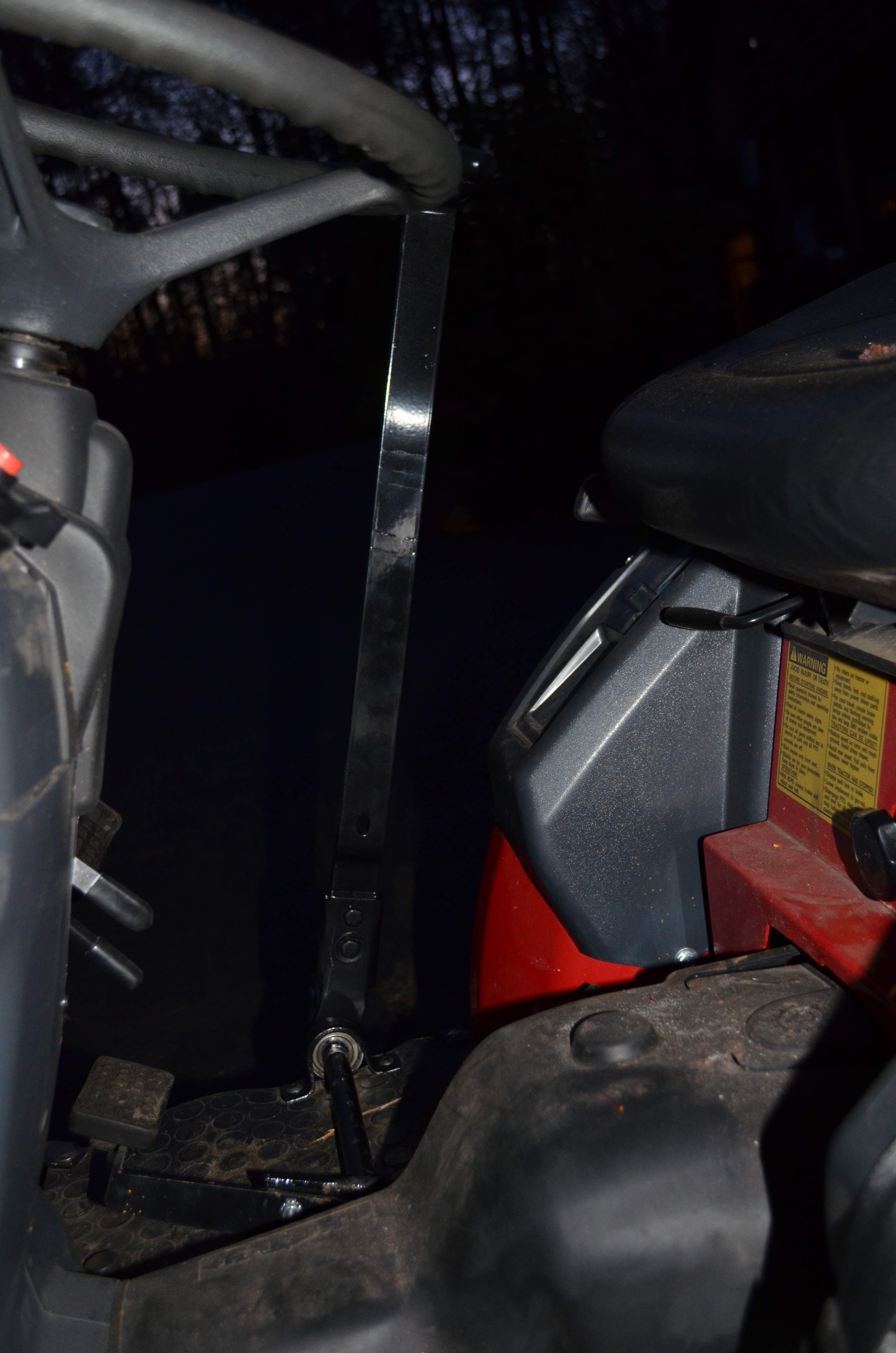

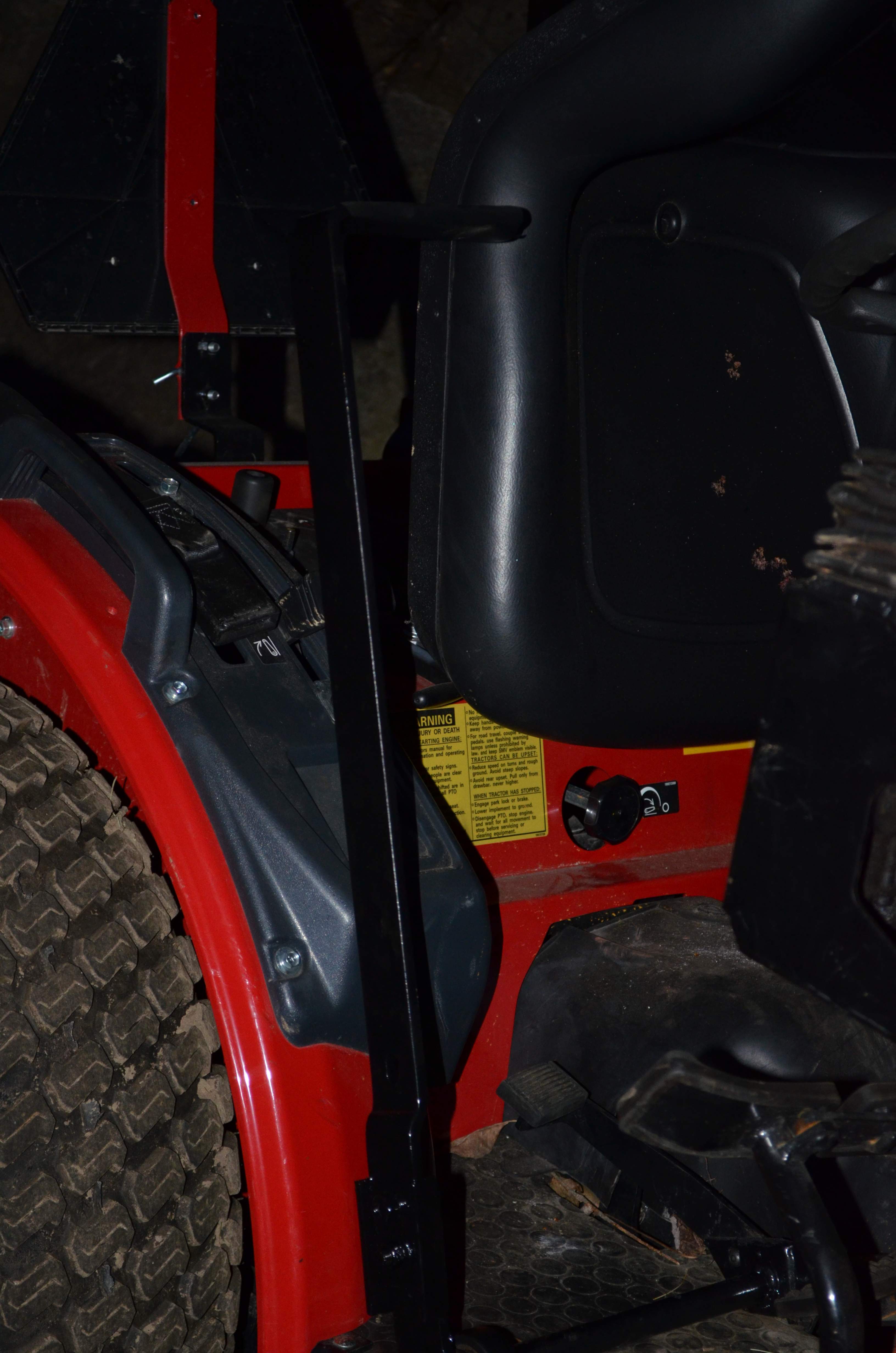

Just finished the final version of my hand controls. Took an implement handle off of an old Deere and bent it. The shaft fit perfectly on my old shaft so I just ground off the old pipe fitting control and slid this on with a bit of grinding. Painted it up, dipped the handle in rubber four or five times a voila!! Can't wait to try it. The rubber is tacky so I have to wait to test it. It is adjustable DSC_3598.jpgDSC_3599.jpgDSC_3600.jpg because I used set screws to mount it. Should be ideal where it is.

This is the modified second version. The first worked well, but this one is higher, looks better, and allows my long legs to fit under it.

HHAHAHA Yep, I sure am a "pig" been at it 28 years, MC accident too. I've been making hand controls for things for a long time, this one was actually easier except I don't weld and had to rely other people to do that for me. The first set was 3/4 round stock and pipe fittings to figure out what I really wanted to do. It worked well, but looked lousy and also got in the way of my feet. This solves all problems and also has the advantage of me being able to operate the loader with my forearm as I work the bucket. Major advantage.
