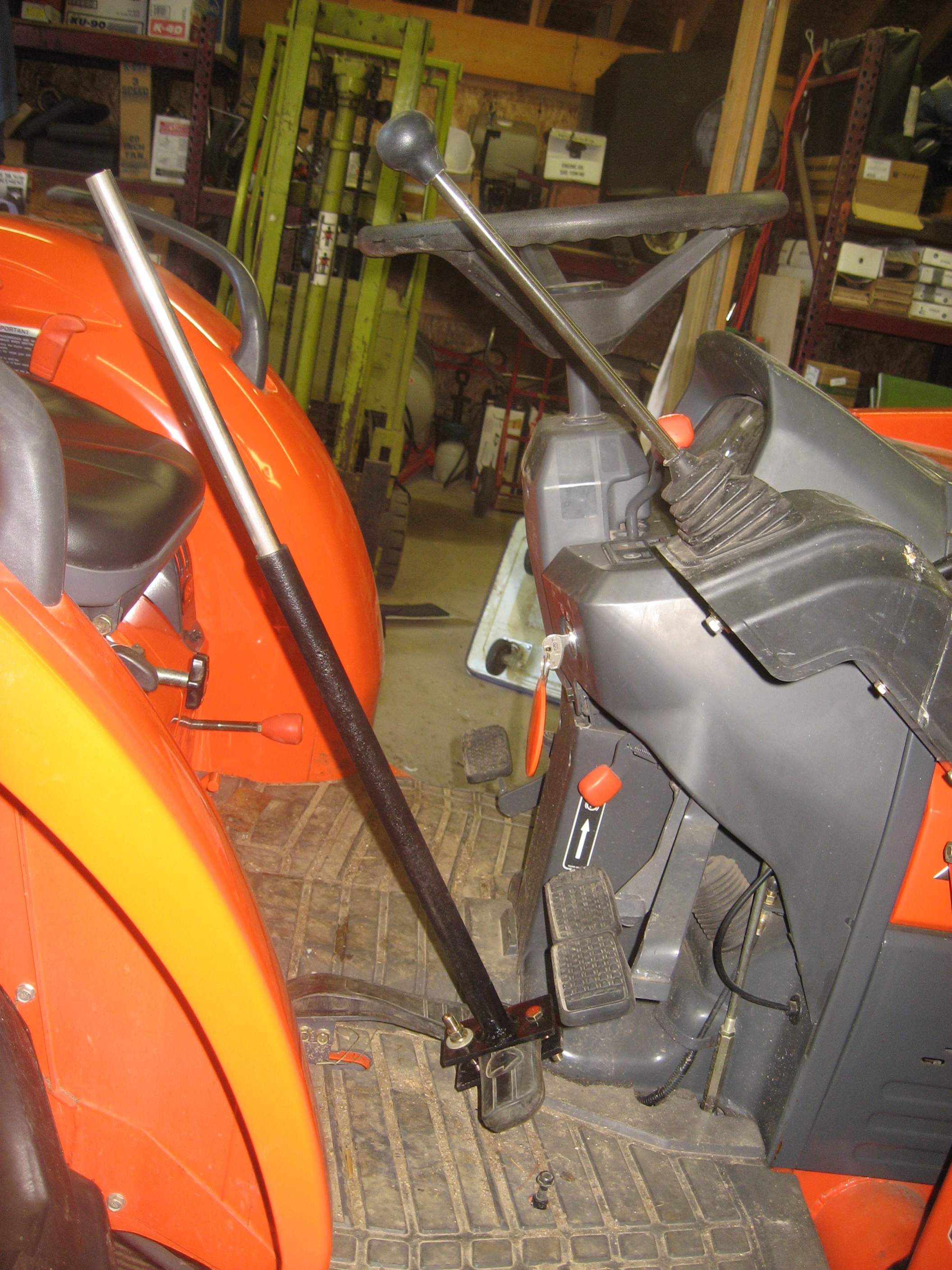

Thanks for posting this kootch.I was recently diagnosed with MS and now I'm having trouble lifting my right leg on and off the treadle for the HST.I was hoping to find a modification that would allow a side-by-side foot pedal that way I could operate the FEL at the same time.Bravo to you for finding a way to overcome that particular challenge.
   / Finished hand controls for paraplegic #46
HHAHAHA Yep, I sure am a "pig" been at it 28 years, MC accident too. I've been making hand controls for things for a long time, this one was actually easier except I don't weld and had to rely other people to do that for me. The first set was 3/4 round stock and pipe fittings to figure out what I really wanted to do. It worked well, but looked lousy and also got in the way of my feet. This solves all problems and also has the advantage of me being able to operate the loader with my forearm as I work the bucket. Major advantage.
Are you really able to operate the loader lever while operating the HST with your forearm? I've been trying to figure out a way for years to operate the FEL and HST with one arm at the same time. I've done a simple lever like this on several tractors. lippert 2.jpg

A couple of small suggestions:
For starting the tractor, why not wire in a momentary switch to bypass the clutch pedal safety switch? Doing so would mean no more jamming down on your leg to close the actual clutch switch. Instead, you just push in on the momentary with one hand while turning the key with the other. You could start the tractor either way, but the momentary would be just for you :).
For welding, have you looked at an inexpensive Harbor Freight MIG model? Just add the shielding gas for MIG. I think a 110A costs around $200 before the gas/hookups.

Topher265,, good idea. A button of some sort on the dash to bypass the foot one.
Also, maybe some sort of loading dock where your wheelchair would be "level" with your tractor,
would eliminate the stress on the steering wheel, perhaps.

Looks like something useful even if one is not paraplegic.
I might do something similar to make it easier to run my rear mounted snowblower in reverse. As it is now when I turn to look over my right shoulder and step my heel on the reverse pedal, it's pretty awkward and I often hit my joy stick with my knee.

I missed the part about the switch!! 2 years later, but I think I will do just that, thanks for the suggestion.
