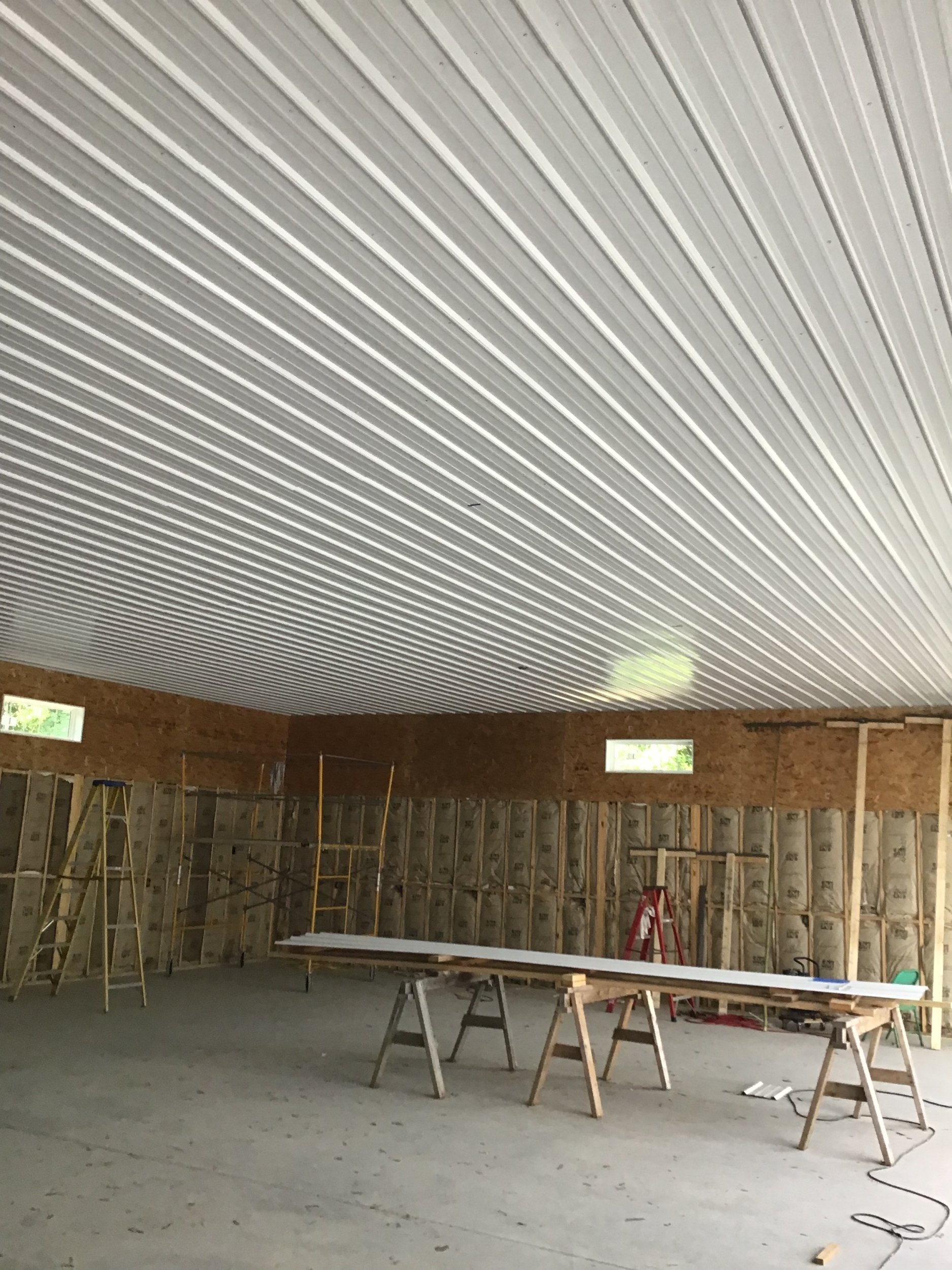

Took me about 3 weeks but I finally finished the metal ceiling on my new shop under construction. 16 and 8 ft panels. My wife helped me I put it was still a lot of work

I see you made yourself a couple of T stilts. I made one for my ceiling project 40 years ago and agree, it is a lot of work.

Looks great. Definitely the way to go for a ceiling. When I did mine (12 foot) I had drywall lift and two sets of bakers scaffold. It went pretty well and I did it all as a one man job but I limited my sections to 12'-6 in length.
/ Finished the ceiling on my shop #8
Well done. I recently put up over 17 feet long x 4 feet wide 4 inch thick ( 1/16 inch steel, 4 inch spray hard foam the another 1/16 inch steel) on my ceiling. The drywall lift strained a bit to get them up, sagged on each end so a combo bottle jack on each end took the sag out so the tongue and groove panels would fit together. The bright white steel helps in the room.

The metal cost $3.05 per ft for 29 gauge that is 36” wide. I bought it from a local place that buys the metal in large rolls and then form it to whatever length you want.

I considered Sheetrock. One of the guys who gave me a quote told me that he couldn’t guarantee that the Sheetrock would not develop cracks since the space would not be conditioned. The cost for the metal was cheaper if you don’t consider my labor. Sheetrock was going to cost $4200 and I have about $2800 in it. I would have also had to paint the Sheetrock which would have been an additional expense and work. Really though, the main reason is that I just like the way it looks.

Valid reasons. I had not factored labor as I have a sheetrock jack.
Any considerations for electrical grounding as you will likely have metal light fixtures in contact with the ceiling?

The material cost is higher for the metal compared to drywall but after that, all the advantages go to metal. Metal is lighter in weight. It only has to be supported on 48" spans while drywall requires 16 or 24. It's prefinished and will never require painting. Installation is faster and easier.

Very nice! Makes for a nice bright interior. How far apart are your rafters or trusses?

I want to do the same in our metal garage, but the rafters are on 5’ centers and I want to blow fiberglass insulation above it too. They told me for the span and insulation weight I need 26 gauge steel.
