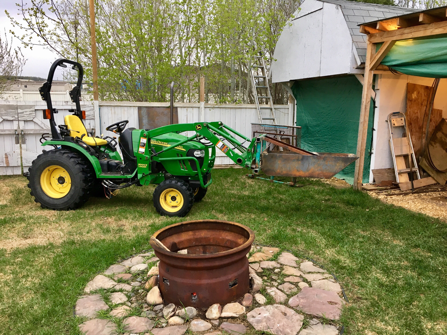

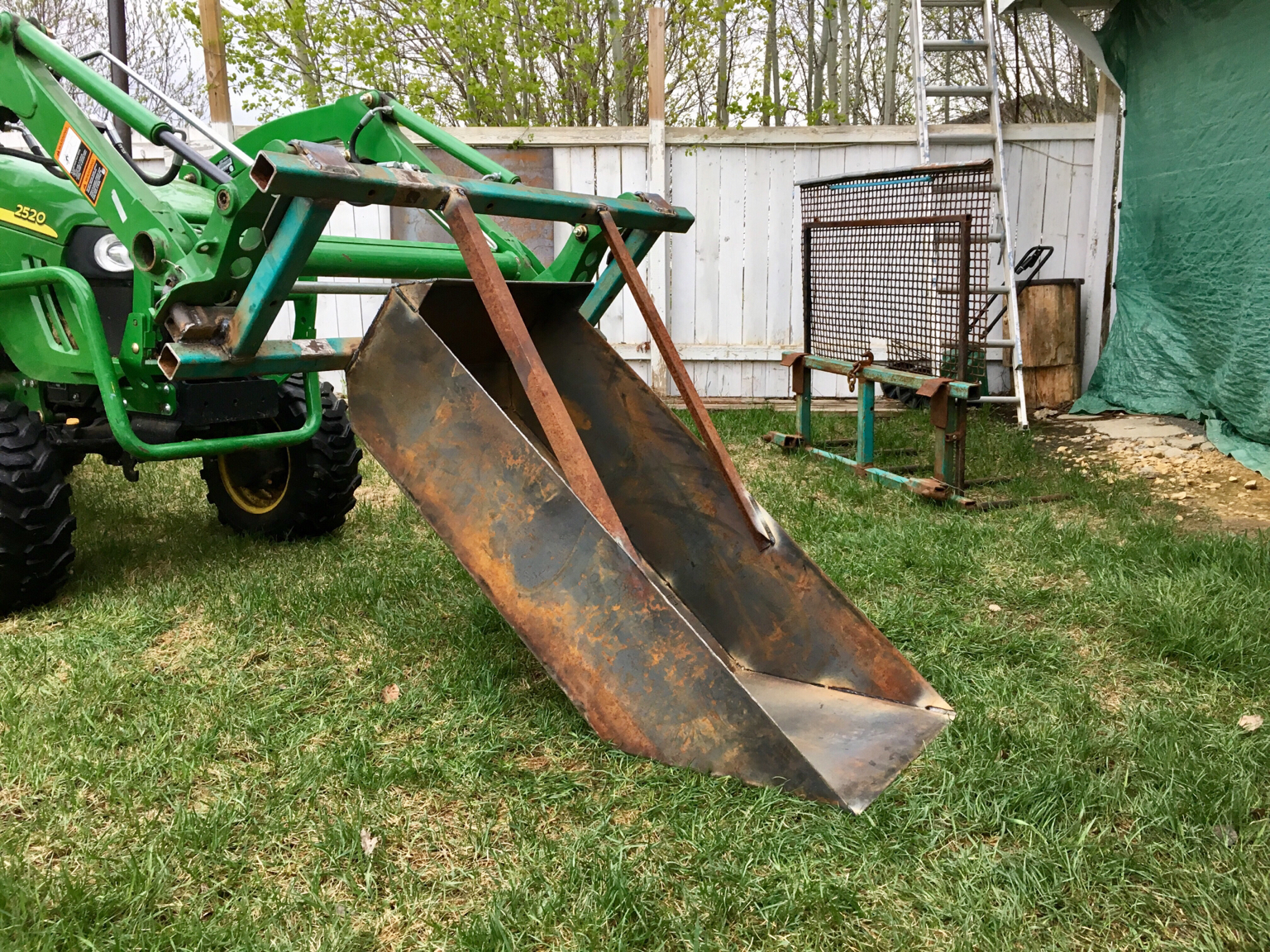

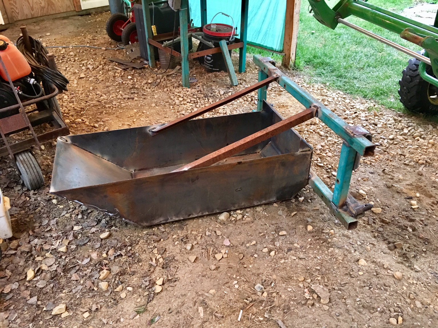

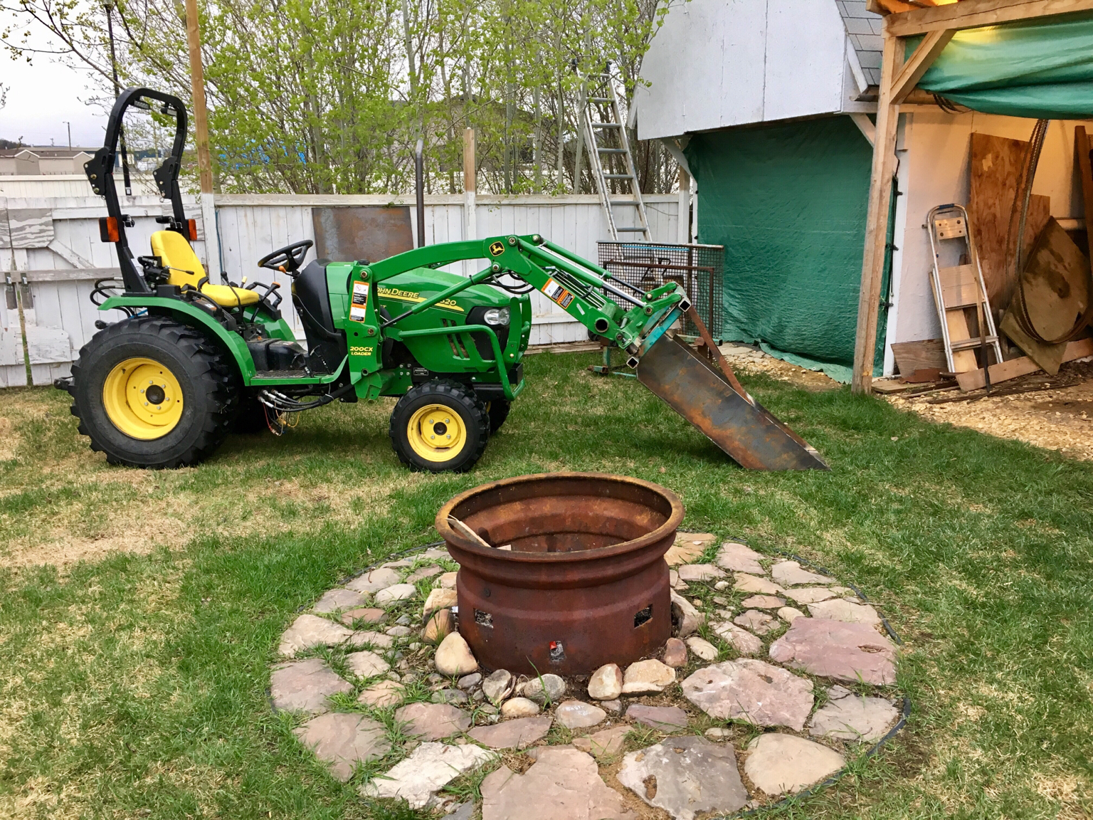

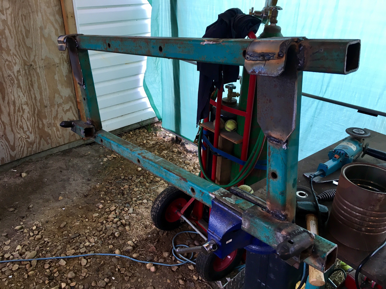

Finished the wash bay bucket today.
   / Finished the wash bay bucket today. #1
BKBoiss
Gold Member
Nov 27, 2013
304
Slave lake AB Canada
2520
So as usual I forgot to take pictures but did remember half way through. I just finished building a bucket to clean out the sumps/trenches whatever you want to call them in our wash bay. I'm a little worried because of how small my tractor is but I'll try it out in the next week or so and see what happens. IMG_4206.JPGIMG_4208.JPGIMG_4210.JPGIMG_4211.JPGIMG_4212.JPGIMG_4213.JPGIMG_4214.JPG

Is this something that you use to scrap the floor and shovel/push slop in. Could get heavy. Definitely hold more than a bucket.
This is meant to clean the trenches in the middle of the bay. So when it's in use it will actually be digging 2' below the surface the tires are on.

So your tires will be straddle the trench as you drive one end to the other? At 2 feet deep I can see where it will save your back.
Yes. And YES on the back saving.

You won't have tons of breakout force at the cutting edge, but shouldn't need it for what you are doing. Looks to me like it will work fine and be one of those things you can't believe you waited so long to make.
