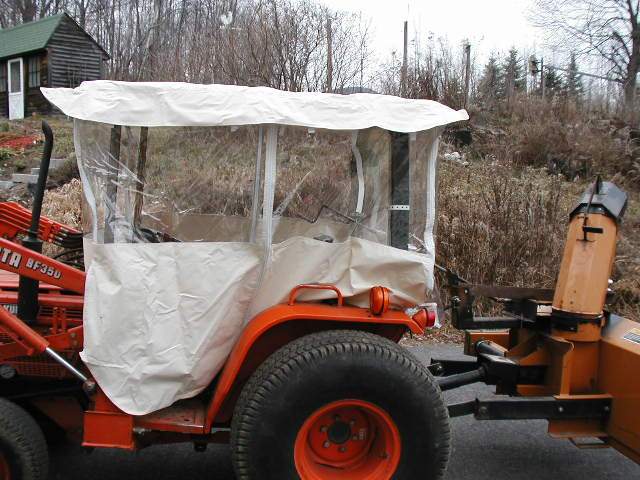

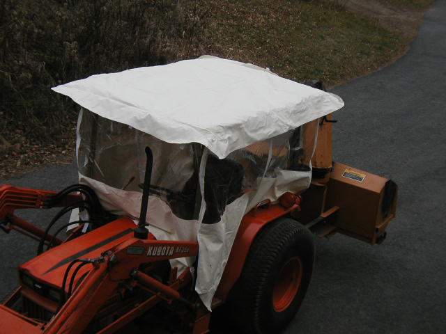

my idea of trying a golf cart cab on my tractor worked out just as I had hoped. It is almost a perfect fit and only cost $100 from Northern Hydraulics. It has zipper entry doors on each side and a zipper in each corner. The two front corners I left slightly unzipped to allow for FEL movement. The top is plywood 45"x59" with rounded corners and support by ROPS and front posts I attached to FEL frame using existing bolts.
The only real gaps are by the foot pedals and I will cut some carpet and drape it down over that area to keep most of wind out.

here is side view.

Now that is cool. I think for running in the snow to clear out a driveway or two this is pretty cheap! Looks like it will keep some of the cold off of you. No window wipers though.

I can't tell from the photos...is there a canopy on the tractor?
   / finished winter cab
Tractor had no canopy but did have ROPS. I added meetal support up from bolted to FEL frame and then put plywood cut to correct dimensions 45"x59". I just used loops of wire to tie down plywood around rops and front support.
