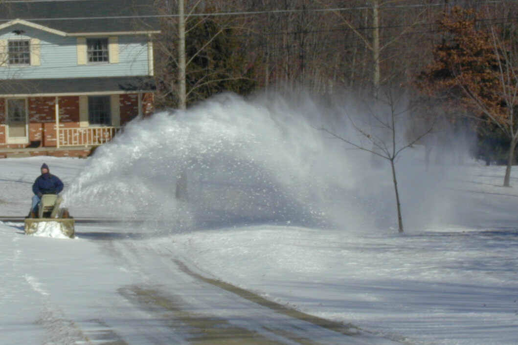

OK, I'm a little late on this one, here's my view.
I was trying to setup my CUT with a belly mower and before I found all the hardware needed to make that work, I came across a Cub 1872. The cub has a 60 deck and and mows really nice. I paid 2K for the tractor/deck/54 hydraulic snow blade, the tractor had 650 hours on it when I bought it.
I concluded I was better off putting those mowing hours on this much less expensive machine, plus, I've never had a Cub repair I couldn't do myself. You can pickup a 45" snowblower for one of these for 3 to 400 dollars and they do a great job.
I find myself using two tractors on a lot of projects, I'll be moving dirt with the FEL and trailering it somewhere with the Cub.
This past spring/early summer I got the Cub stuck more than a few times and just pulled it out with the 1220. If I'd stuck the 1220 with the finish mower on, it would have required a lot more thought to get it out.
I use the 1220 and RM 59 for a couple of acres of open field and have used it on my lawn around the house when I broke a wheel on the Cub deck, it's nice to have a backup.
The Cub doesn't ride as nice, it burns a lot more fuel than the diesel, but for me this was a good option.
I attached a pic of the Cub movin some snow.
Good Luck
Curt
