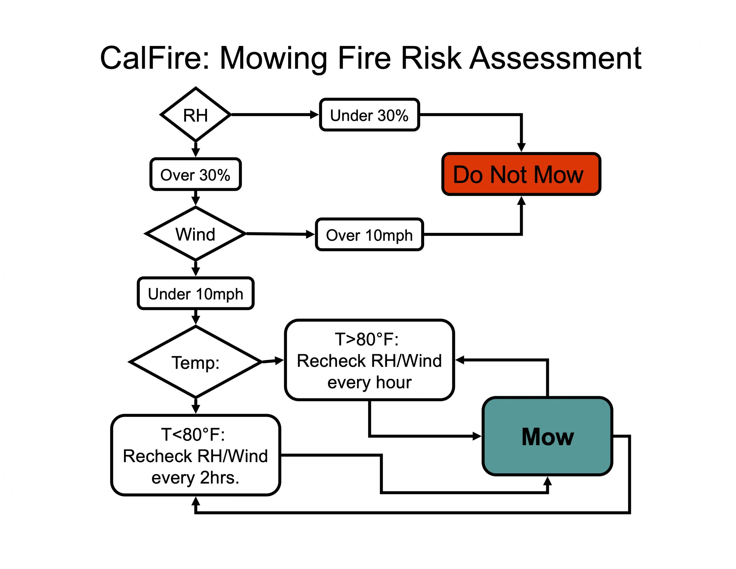

FWIW: this is something I found on the CalFire website a long time ago, and then put into a flow chart for my own use. Use at your own discretion, and risk;
All the best,
Peter
P.S. I just looked for this on the CalFire website, and couldn't find it, so it may be outdated advice.

Well - that cut it for me. The only time the RH is over 10% - middle of the night. AND - any time after about 10AM the temps here are certainly over 80F. Besides - any mowing I would be doing after 10AM - I'd turn into a beet red prune. My tractor has a canopy - not my riding mower.
OK - Eric, now that makes sense.
I think I'll just hook up my big 'ol disk set and disk up a fire break up on the high meadow. That will establish a fire break between my big lake and little lake. I could also run up/down the west property line.
