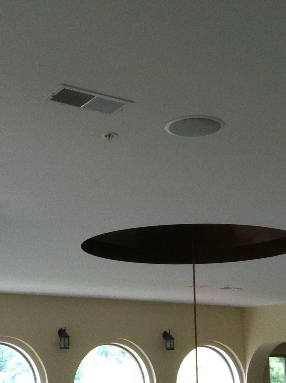

As we were building our house I thought of the time it might take to have the fire department out. We live at the end of a one mile private road on the outskirts of town. I stay in hotels often and was alway seeing the sprinkler systems. I thought it sure would be good to have one.

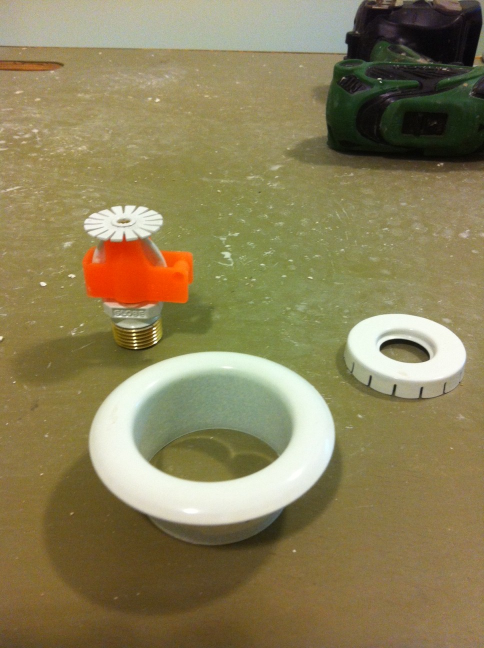

My first attemp at it was talking with the Korson(sp) fire group, very pricey. A plumber neighboor said there are dig differences in a comercial system vs. a home system. A comercial system is designed to pump water in all the heads, at the same time. A home system is really just meant to have a few fuction at one time. We pexed in 3/4" lines from the main city water line. Used Tee's with brass shower head 90's. We have nearly 40 sprinkler heads installed, as you can imagine there would be to much presure loss if half of them were open. The main purpose is to contain a local fire, buy you time to get out and time for the fire dept to get there.
The sprinkler heads cost less than you might think, $6-7 with cover rings. Pex tubing is cheap and easy to run. I have never had a crimp leak
Our house is all concrete and steel except some partition walls, so I wasn't to worried about the house burning to far but it's the smoke that with kill. As yes, we have smoke alarm system too.
So if any one is building now, I highly reccomend installing a home sprinkler system. Mine cost me less than a $1000 including labor of having a licenced plumber help run pipe.

The local fire dept has written permission to pull water out of our pond, but it does not give us a break in the ins rates. The nearest fire plug is a couple of miles away. If building a new house would be pretty cheap to add the sprinkler system to it, but retro into a older house is to many bucks.

Sprinkler systems are mostly to save the building, not to save lives because the smoke will disorient you or kill you before it gets hot enough to trip the sprinkler heads. At least that's what I was told by a knowledgeable fire chief.
Smoke detectors are more effective in saving lives.
As for water freezing in the lines, there are "dry sprinkler" systems where pressurized air is used to keep water out of the lines until a sprinkler head opens.
I agree that a connected garden hose is a great idea as long as you know what you are doing and know when to get out of the house. Many people have died from the smoke trying to stop a fire instead of getting out. For most single story houses, it's best to do any firefighting like that from outside.
