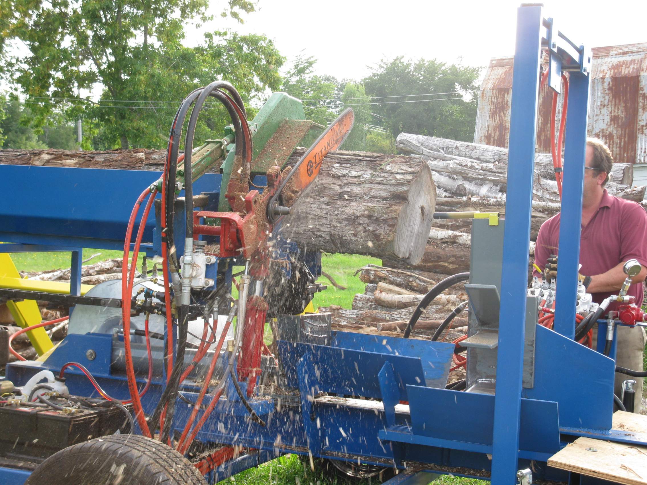

muddstopper said it about the 2 stage pump is a real problem. If i had to do it over i would bite the bullet and buy a pressure/flow compensated pump, it would solve a lot of problems. we used a triple gear pump, 1 for the saw, 1 for the splitter and 1 for the rest of the hydraulic cylinders and advance motor.

   / Fire Wood Processor Hydraulics #9
glastron,
nice looking rig you have there.

Muddstopper has the right thoughts on this, the one that really needs to be answered is the amount of wood do you want to process per hour, are you simply going to dump in a big pile or are you going to stack when it comes off the knife. we stack and with 2 or 3 people you do about 1 1/2 cord per hour. During a normal cut/split cycle i'm waiting for the wood to be cleared and if we are cutting 12/14 foot lengths then i can really keep them busy.
The saw motor is the big thing, we were lucky and have an F11 with the 404 chain setup. I'm running about 10 gpm on the saw and it should have 15 to 20 but it is fast enough to do the job.
The thing is the saw feed cylinder, trying to keep it smooth, it takes very little pressure to drop the saw into the wood, the 2 1/2 cylinder is really big for this job. We have a sequencing valve so the the wood clamp has to be down on the log before the saw will drop and the saw has to be up before the clamp is released so as not to be able to advance the log with the saw down. We also installed a shutoff when the saw stops when it is all the way up.
The next thing is the oiling system, are you going to bleed oil from the hydraulics or are you going to have a a chain oiler on its own.
