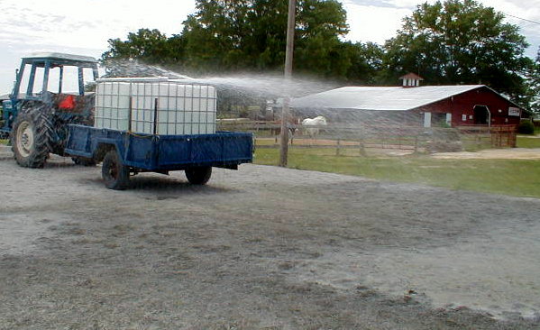

Here's my 550 gallon water wagon with hydraulic centrifugal pump.
   / Firefighting-PTO pumps, nozzles etc. #10
Another try
