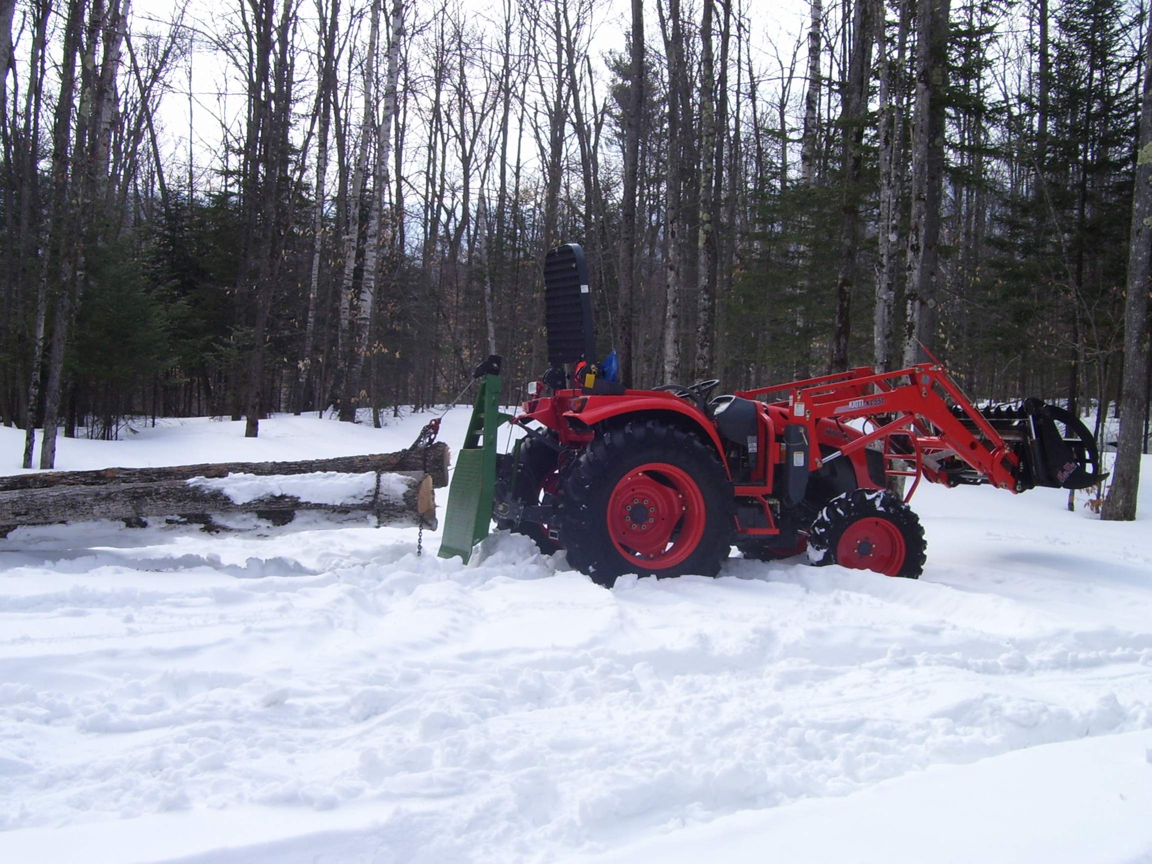

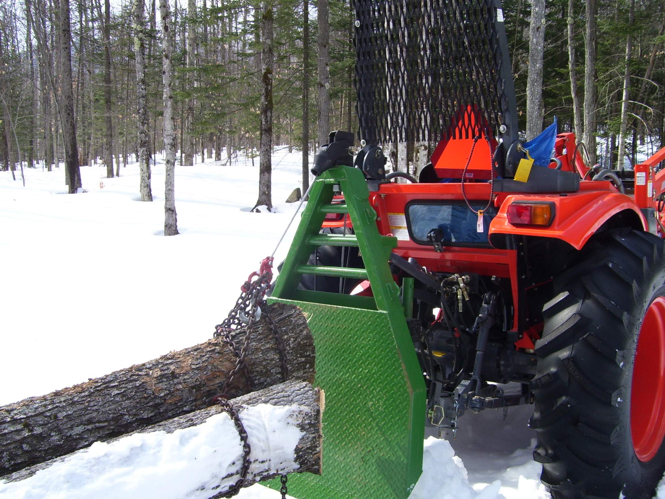

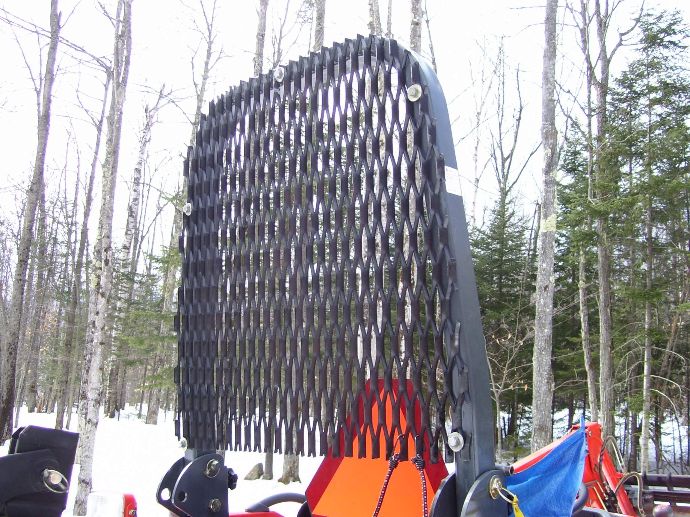

I finally rememberd to grab my camera to get some pics of getting out some firewood. Check out my new hydraulic winch, a gentleman in Northern Vermont built it.I sold my JL601 to Dead Horse and spent the proceeds on it. I added the screen to my ROPS because its very intimidating looking down that cable pulling in 3 logs without it there!!

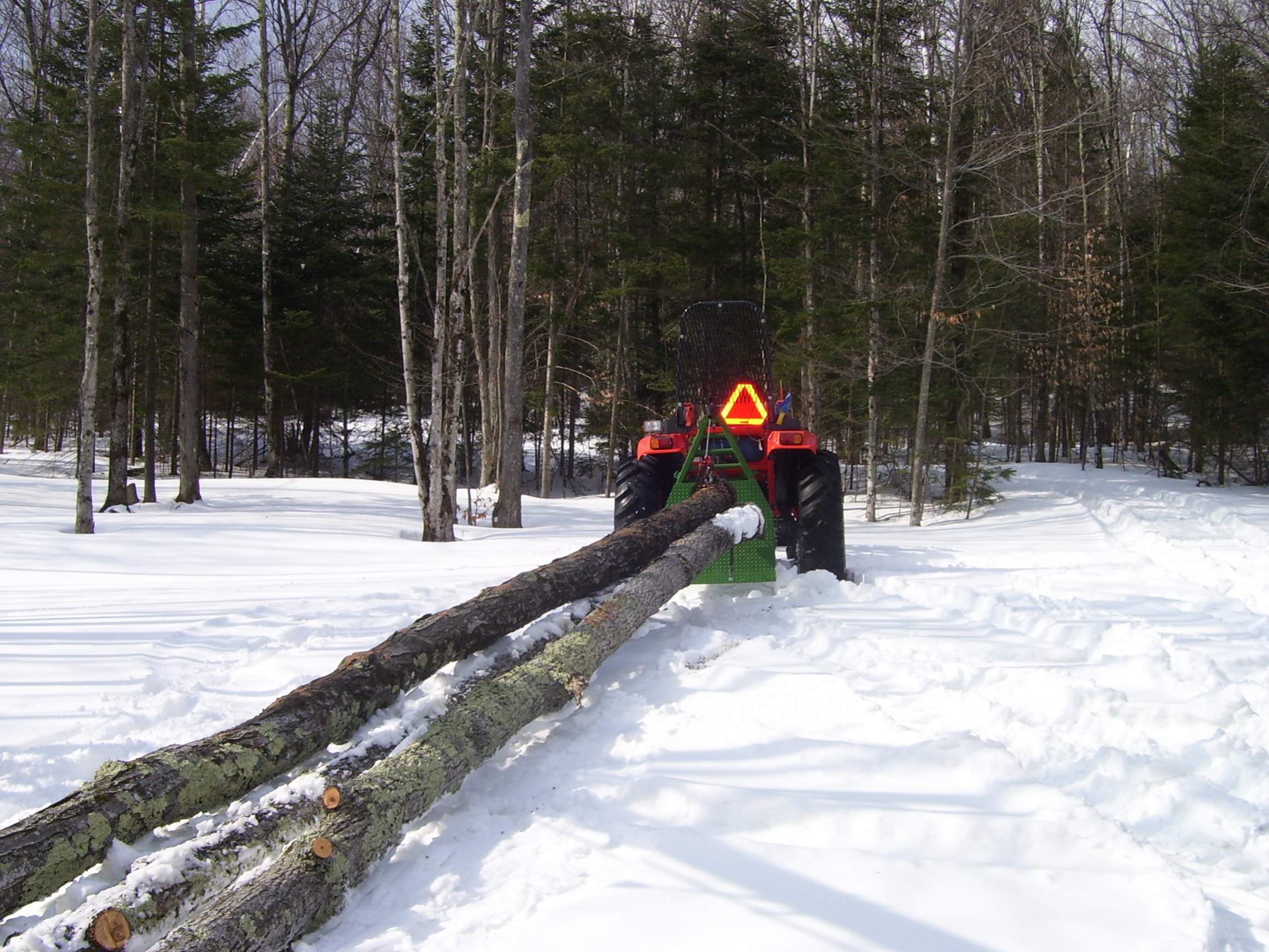

The DK55 pulls 3 logs up hill in snow pretty well, in some sidehill parts of the trail I had to steer with my brakes. I am very happy with this set up, it is pretty efficient and a whole lot of fun!!!!!

Looks like you bought the one for sale on Craigs List....yes? That looks well built, and is probably an animal winch. Very nice, I'm jealous!!
   / Firewood Loggin' #4
Nice...very nice,and no need for rear tire chains either.

The more I look at it, the more jealous I get! :( Dang, that thing is built! It must weigh a few pounds. What brand hydraulic winch is that? How many tons will it pull? I like the fairlead design too.
It looks like you have to operate the winch from the side. If that's correct, it would be a good idea to fasten a safety screen to that side of the unit. Just remember....hydraulic winches do not stop pulling.....until something breaks! Be VERY careful when operating the winch!!!!
   / Firewood Loggin'
I hear ya on being careful! You can select High, Low or Freespool from the levers you see, but to haul it in you run that function off from the remote valve. Its a really neat set up. Its a MileMarker series 70 winch, rated at 12,000lbs.
