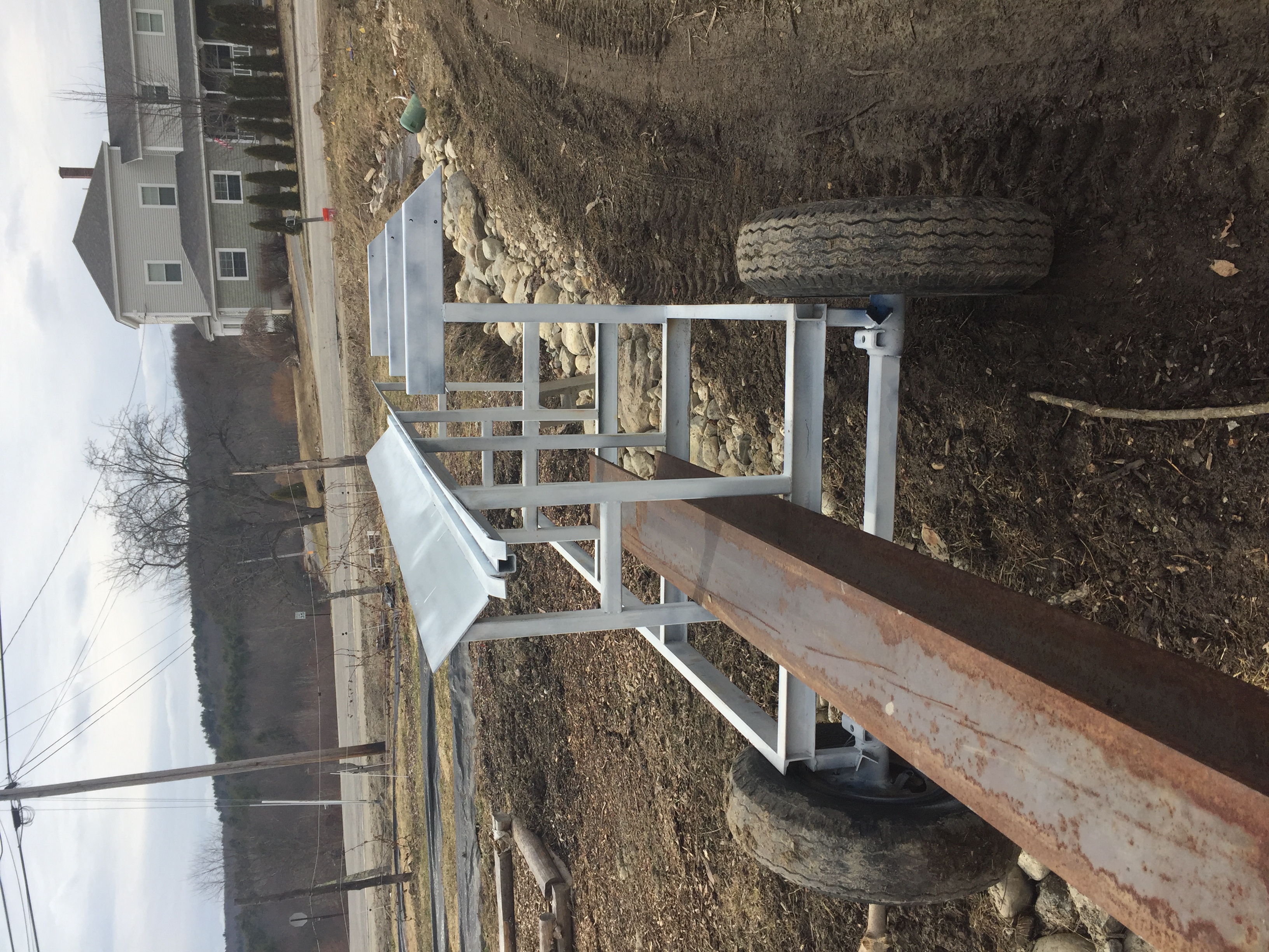

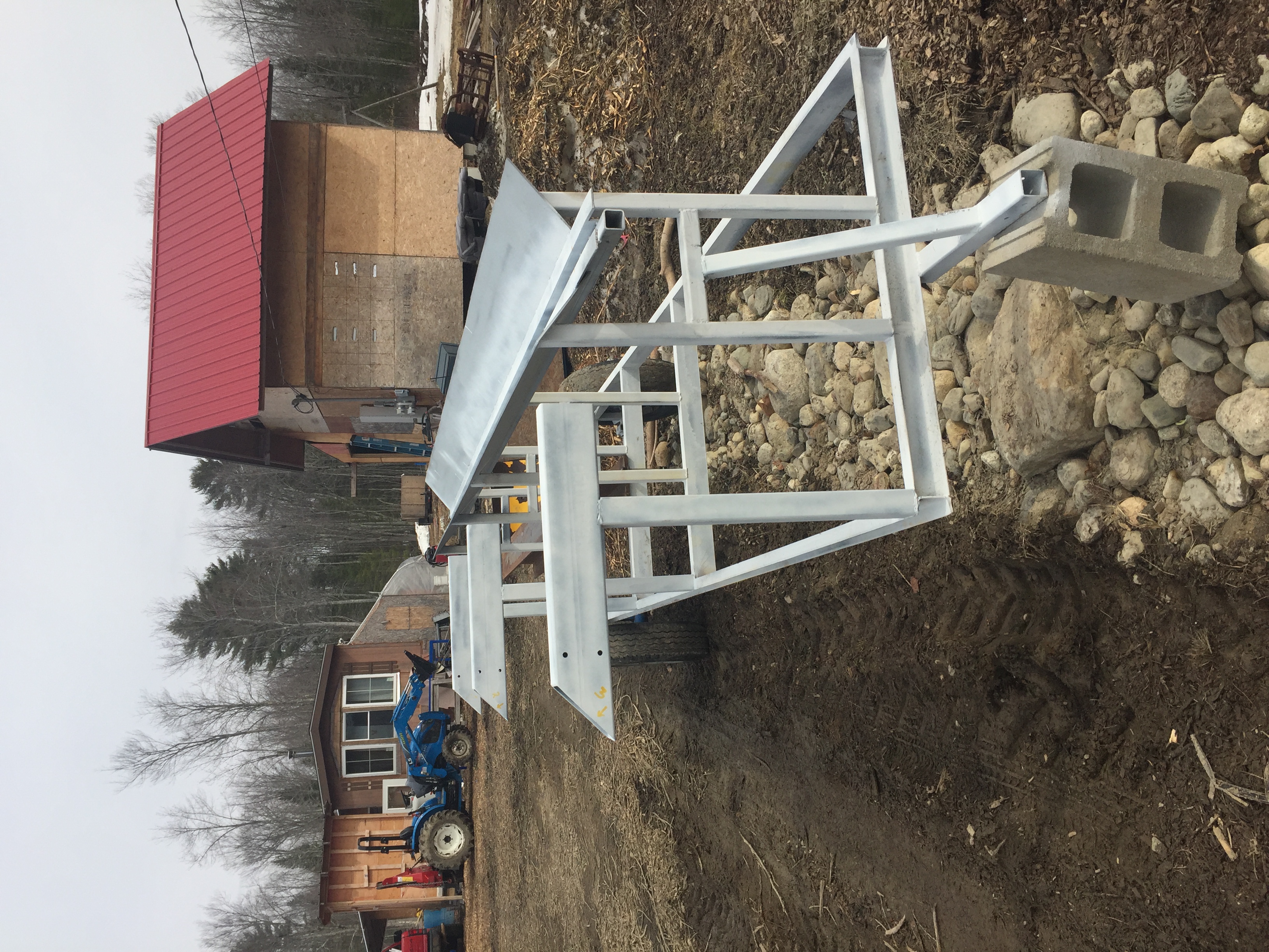

I need your expertise guys. I completed the major design, it is here, its open source to anyone to download, improve etc.
I keep the story short, on the design link above I have wrotten my approach. Also here I have my diagram. Its ongoing now, and I need your help to make some decisions and avoid mistakes.
The main frame is welded, I am waiting the legs and the chains in a few days IMG_0044.JPGIMG_0045.JPG
The splitter circuit will be independent for now with a dual stage pump (sorry muddstopper, I already had the pump!:p) so lets leave it out of the discussion.
