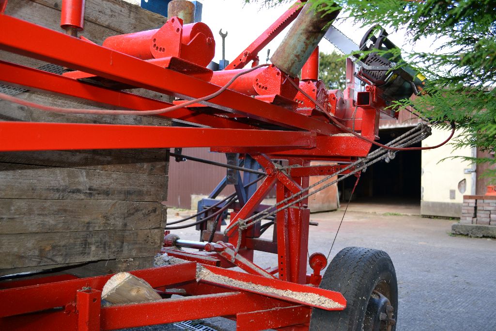

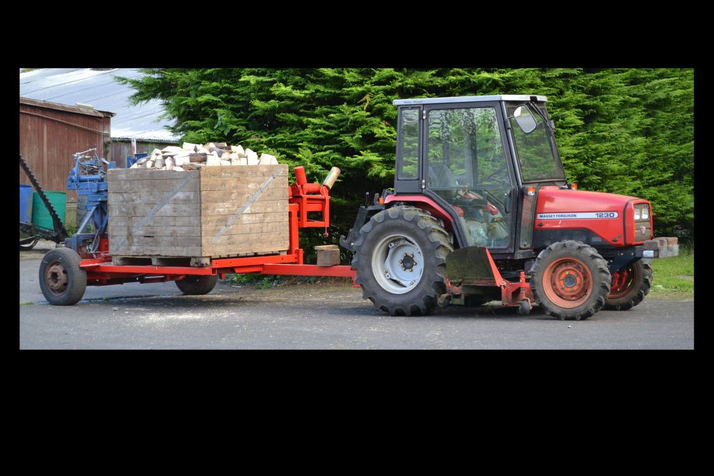

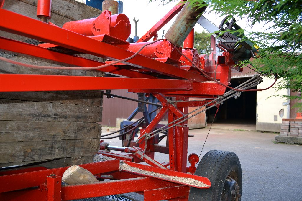

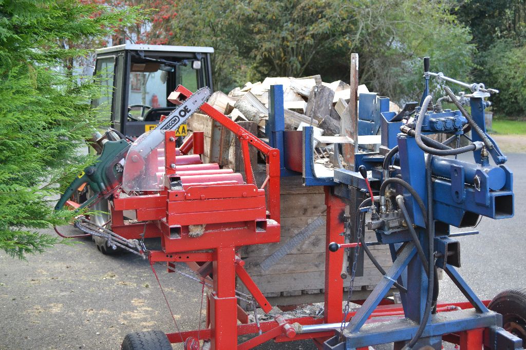

   / firewood processor #5
ferguson what did you use for a motor and pump to run the processer.I'm in the process of making one.I already have a splitter but am wondering if the motor and pump are to small.thinking about running a pump off my small 20 hp tractor pto.The motor and pump i have now is a 5.5 honda and a dual stage pump
   / firewood processor #6
am mine is run off a massey ferguson 4355 tractor (100hp)
it just plugs into the back of the tractor. using the tractors hydraulic pump
