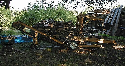

I mentioned my processor on the firewood string, so here it is. It is a chomper from rainelle hydraulics. It uses a shear instead of a saw. i bought it to clean up slabs from my sawmill, but it will shear, and half split, just under 10 inch green hardwood, though it doesnt like the standing dead stuff much over 6 inches. this was his prototype for this particular model, as i wanted one and they didnt sell so well he didnt have any on hand, so i bought this from him. rainelle hydraulics makes many models larger than this, but i liked this one because the infeed is sloped so gravity does the work, and the conveyor will load the truck. it also has a hydraulic winch for heavier longer logs that can be fed with the infeed horizontal. pretty slick i say.

Looks cool. Kinda hard to see in the shade though. I take it the wood only goes onto the conveyor after it is chopped? In other words, the path of travel in the picture would be from right to left?

We'll have to take you for your word, that that processor is in that picture somewhere. Does it have camo paint on it? /w3tcompact/icons/smile.gif

yes right to left in the picture. the infeed on the right can be elevated hydraulicly and gravity feed in small and short logs.

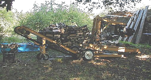

try this out... little easier to see.
That looks really cool. I'd love to see one in action.

Nice looking setup,and you even thought about the shade factor during the warm months.
