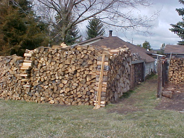

Shot from opposite end than the first picture. The first one showed how the ends of the ricks are held by scrap 2x braced against the cross beam at top that is held by a RR tie on both ends.
This one shows how I had to extend the "bin" due to lack of capacity.
That "bin" is 12' x 12' before the extension by using unsplit and split stacking.

Wow! It looks like you have a house stored in your firewood. /forums/images/graemlins/grin.gif

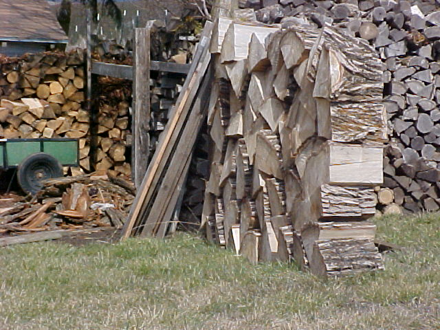

Shot of the bin I have almost emptied to make room for this seasons cutting. The 2x leaning against the right hand frame were holding up the ricks in this "bin". That bin was originally 12x9' but is now 12'x17' after making the additions. It was full last fall. Burnt about 6 cord, sold 2, rest all moved into the bin in the first picture.
You can see my error in the lean of the RR ties. When I set the ties, I -assumed- that they would hold the pressure. One season showed the error. I should have built it so the 2x's would lean in at the top so the pressure would be relieved as the ricks settled. Doesn't show too well but I have been adding things to them to get some lean into the system.
The "bin" to the right is all Locust cut many years ago, actually before I set the RR ties for the current system when I got tired of the nuisance of "chimney stacking" the rick ends.

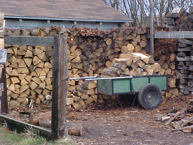

Shot of the third bin, all locust except for the unsplit stuff used to extend the bin. I put that there on my last load on spec as it looked like I was going to get some more locust - didn't happen.

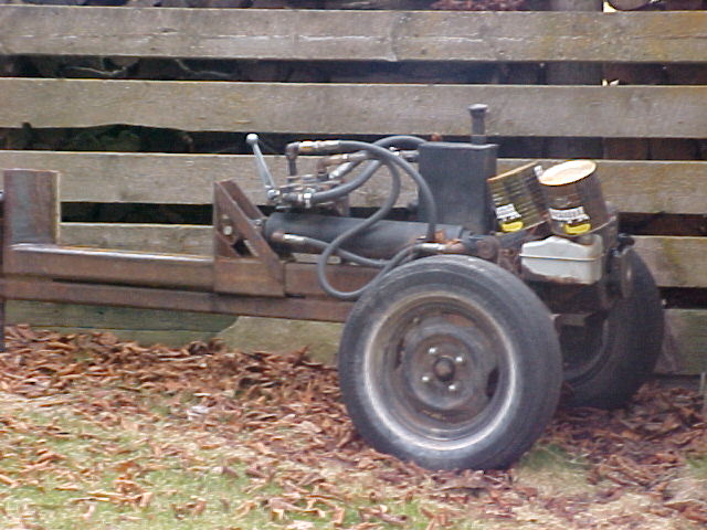

Shot of my logsplitter. This is about mod 6 of a series we built in the shop I used to work in. I moved the axle/motor/pump/tank to the rear end on mine to get them out of the way of the operator's positon. Makes it very tongue heavy but I can move it fairly easily by using a trailer dolly (Harbor freight).
