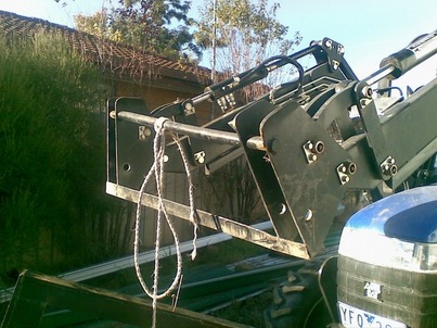

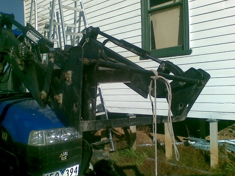

Hi,
Hopefully this is in the right spot.
I bent my quick change mechanism (see fotos). Looking at how its bent I'm thinking I will have to at least replace the angle iron section at the bottom.
My thoughts so far are to also replace the solid round part where the bucket hangs from as well cause of how its bent and how this affects the alignment of the quick release and hydraulic arms
Dont have a gas axe but have managed to staighten the odd bit of steel in the past with the arc. To me the round is beyond this method, but hey I'm open to suggestion.
The biggest concern I have is the fact the hydr arms cylinders no longer have the same travel (arent the same length as each other). At this point the cylinders dont appear to be bent.
Would I have to undo the hydr lines to do this? Do I have issues with air locks in the line/cylinder once I am done?

Block the right cylinder (looking fwd) travel with a chain and push the left cylinder forward until it's straight. If you don't have enough grunt to do this pull it out with the chain on the right side and grounded to a BIG tree. Then bunt it in reverse until its straight. Don't use reverse traction, there's not enough force available. Use reverse momentum to do the job. You'll get it close enough to put the bucket back on. Do this with the loader frame down low.
If you are above average in cleverness, reverse the plumbing on one curl cylinder and use the twisting moment to get it back into shape.
I've had to do this for the neighbor, TWICE.

Thanks for the reply.
Was pretty busy today working on customer stuff, so my father fixed her up. From the very brief moment I spoke to him sounds like he used the hyd cylinders with the help of some chocks placed between them and the quick release to straighten it out.
Connected the forks up later on without issue, so it must be reasonably good in its alignment. Looked ok when he unloaded a truck load of round bales this evening.

Yup, if you block one side out and curl it back, it will twist it back the other way.
