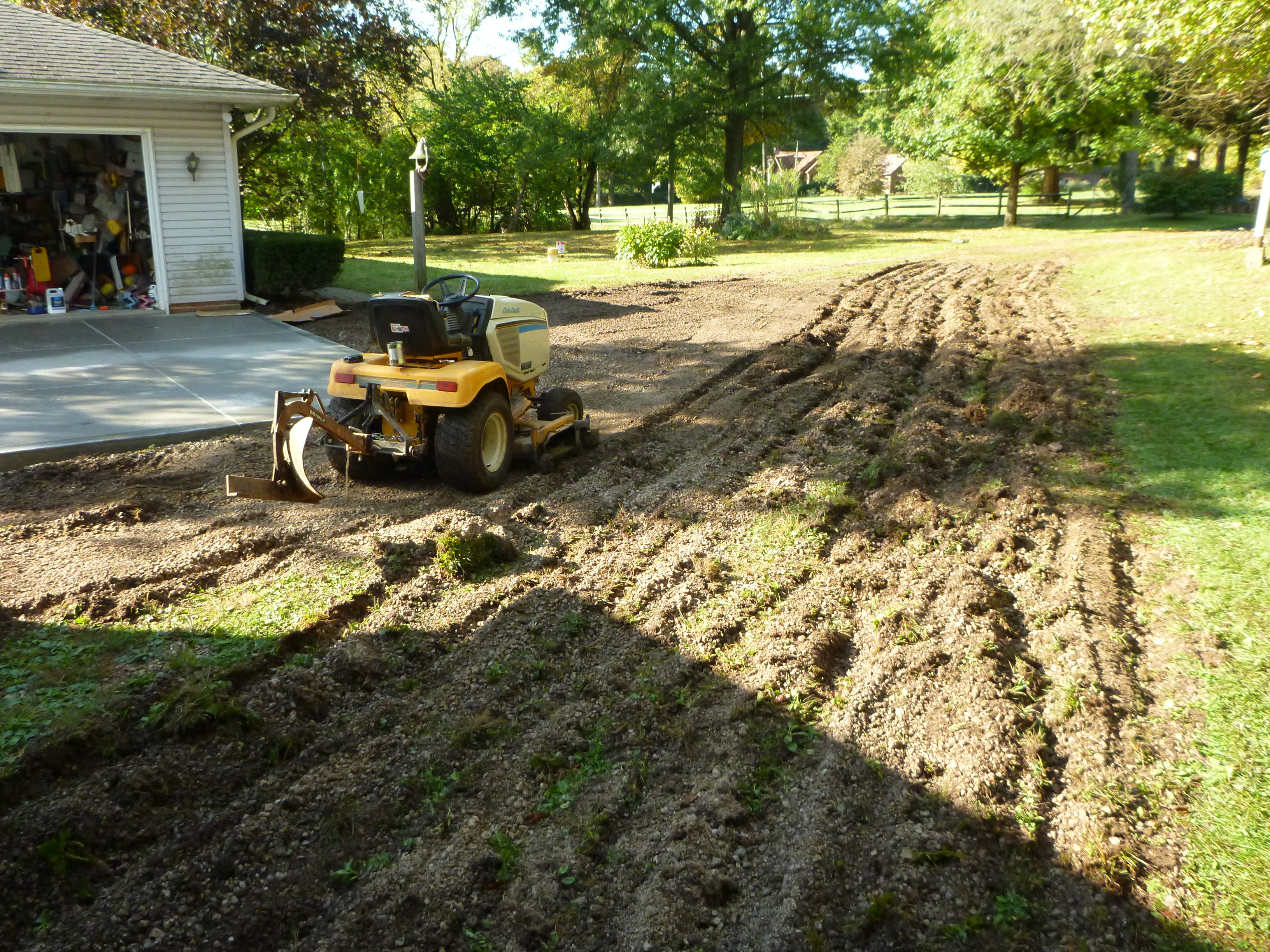

After 20 years of a limestone drive it grew up in sod. We joke about having a "green" driveway. I scraped off 2+" of the squishy topsoil this past spring intending to put down a fresh layer of limestone just to have a clean (drier) surface. I started to think about a concrete slab but this area has (had) terrible base material and heaved 3" in the winter. It kept me from pouring a slab for my "outdoor" workshop. The concrete job and base preparation is another story but I just had a 19 x 21 foot pad installed.
Now the problem was that the rest of the drive needed a nice clean layer of limestone. In order to get the water to drain properly (and be flush with new pad) I had to grind down and level/smooth the existing base about 2" lower. The surface was a firm base of gravel mixed with dirt. I could not scrape it down with my TC-21 without loosening it first. I don't have a box blade which is probably the tool of choice. I tried a couple of homemade tools I had for the Cub Cadet including a small ripper tine... but just couldn't get into the hard rocks. Then I remembered the old Brinley plow. Hasn't been used for years. Well that dug right in. I had to watch that it didn't go too deep. It wasn't pretty but it did tear up the surface enough and loosen it so the bucket could scrape. Using a combination of the loader bucket and a rear scraper blade on the Cub Cadet and shovel, rake and mattock I managed to remove about 2-1/2 yards of material. Four days of work. It's all smooth, graded and ready for 2" of #6 crushed limestone. I have 12 yards (18 tons) ordered for next week. Even if I get a good spread job I'm sure there will still be plenty of raking and scraping to do.

How long do you expect 2in of limestone to last?
Here 2in of crushed item 4 would hardly last the summer on my wet shaded area. I have since went to 1.25in crushed to build up a base and get things packed in.
   / First driveway plowing Oct 7, 2019 NE Ohio #5
+1. You (OP) might want to rethink your plan of attack, if longevity is important.
