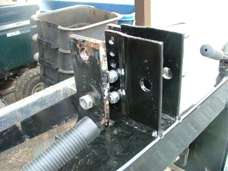

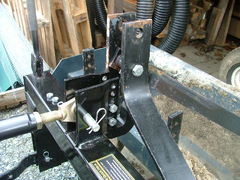

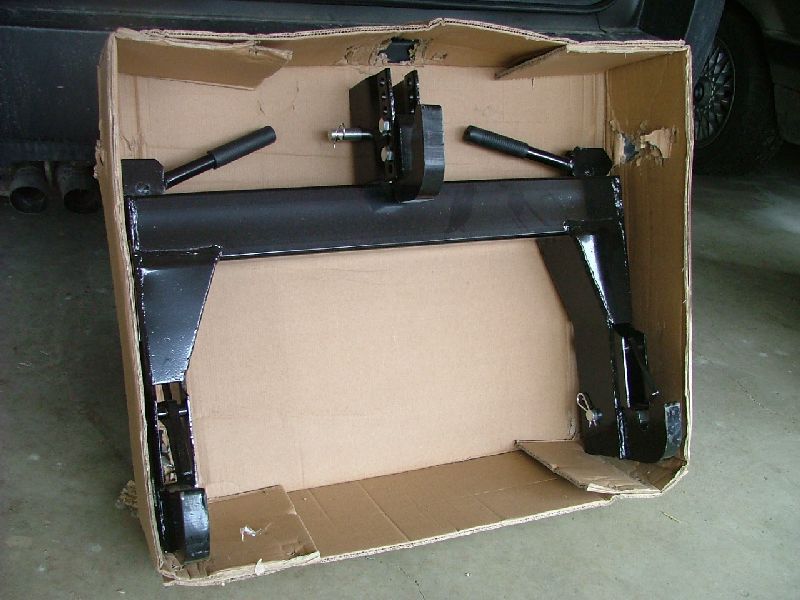

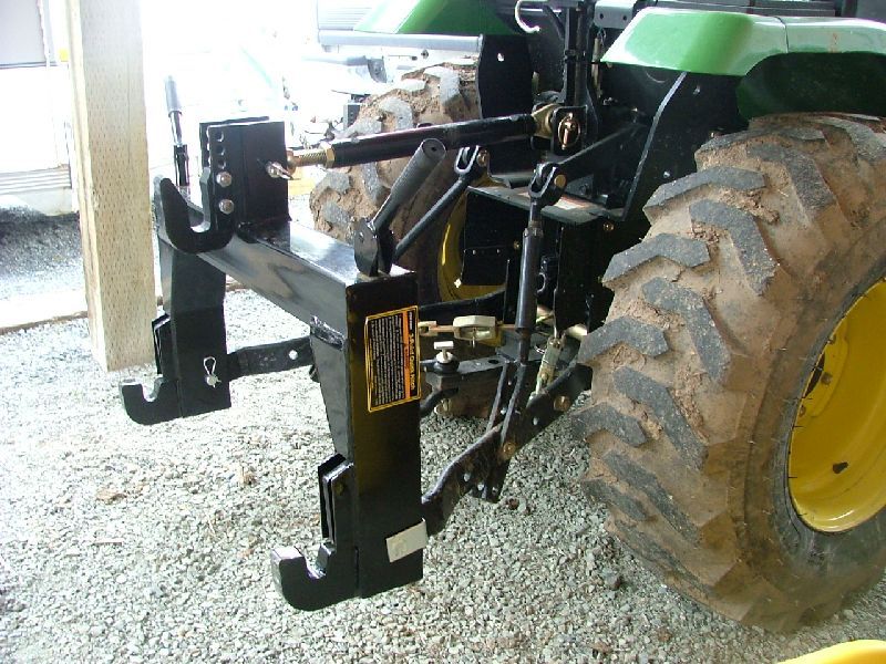

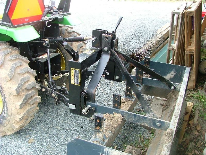

I've been wanting to get a quick hitch for my 2320 for a few months now. The only 3-pt implement I have is a 5' box blade and it's kind of a PITA to hook and unhook. My dealer wanted $250 for an I-Match, which was a little too pricey for me given that I wouldn't use it all that much. Every Harbor Freight catalog I get, their $69 quick hitch stares me in the face. I had read a few things about it on this forum and I finally decided to get it and try it out. Here's my impression so far:
- This thing is beefy. I don't know how much it matters, but the HF QH has a larger horizontal piece than the I-Match.
- Welds are sloppy but look solid.
- Alignment and measurements appear to be pretty close to ASAE spec.

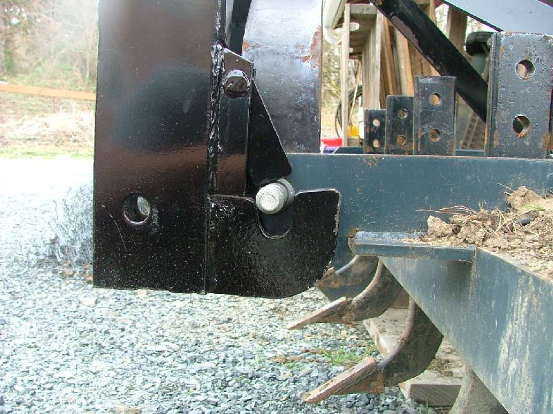

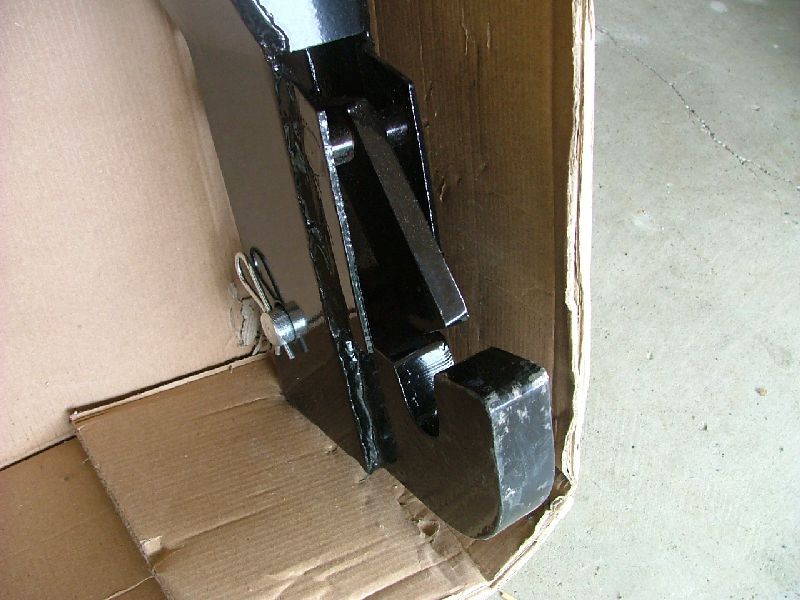

- Lower hooks do not need bushings like the I-Match and the "flap" that keeps the implement pin from popping of the hook is sloppy. The pin is cradled nicely in the hook, but this "flap" leaves a huge gap and does not hold the pin in place like I would expect it to. I'll probably weld an extension onto the flap to close the gap.

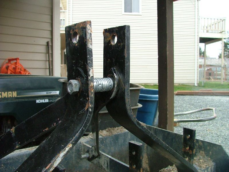

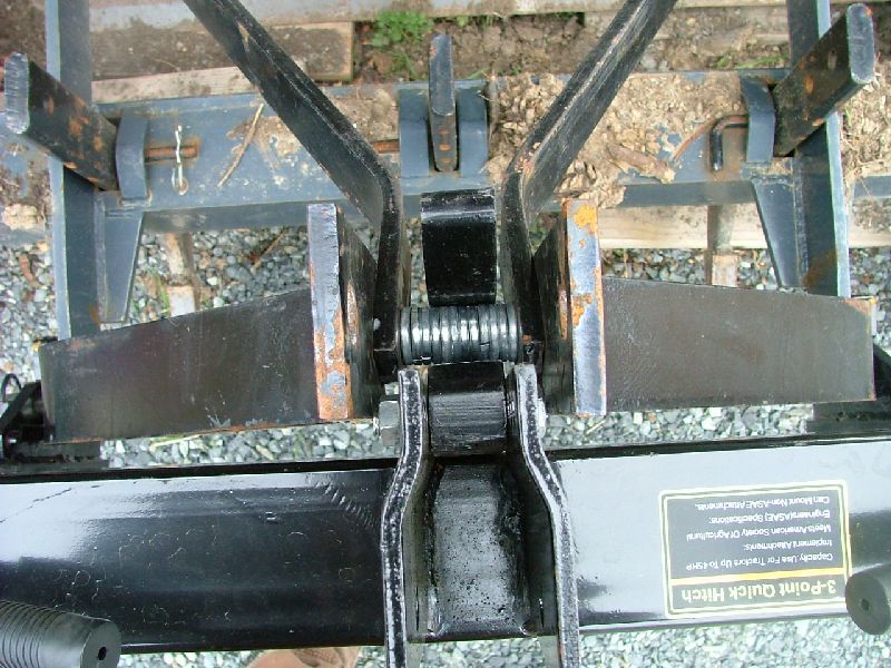

- My BB needed some adjustment to make this work. I needed to do some grinding on the BB top link brackets to clear the QH hook, use washers on the top link bolt. I also had to grind down the QH hook bolts to get the hook to engage properly.

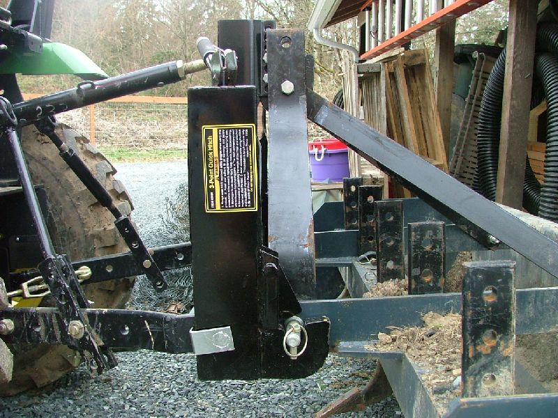

Overall, with a little tweaking, it seems to be working ok. Since the BB is my only 3-pt implement, I'm happy with the setup. I may buy/build a ballast box at some point, but that should not be a problem. If I had a Frontier BB and will use other Deere implements, I would have gone with the I-Match. Since I'm not made of money, I'm game for whatever works.
The best part of this deal? The grin on my face the first time I was able to back up to the BB, hitch it, use it and drop it back down and unhook without getting out of the seat!

Yeah, going with a Deere BB and I-Match would have cost me over twice what I spent.
Did either one of you do anything about the big gap between the flap and the lower hooks? I don't think the pin will pop out by it still bugs me. At some point, I'd like to weld an extension on the flap to close this gap.

Havent had no problems yet, but it does leave a lot to be desired.... If I see anything that looks unsafe, i'll definately weld some xtra steel on them..
