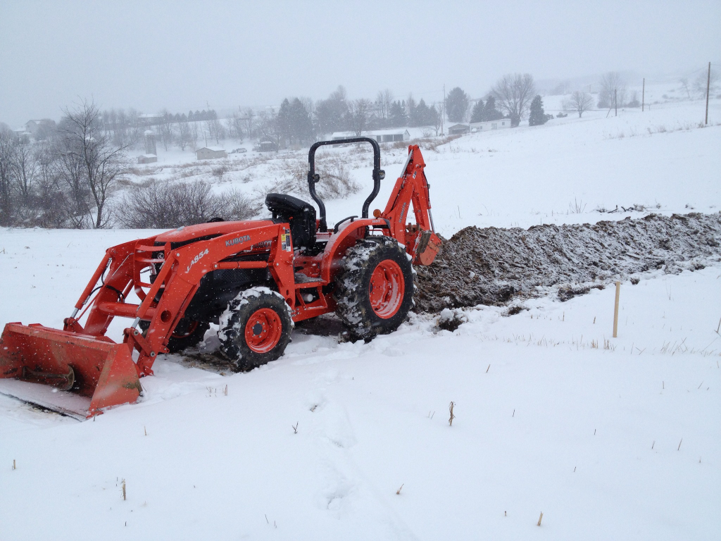

I have a bh92 on my 5240 and it has been very good so far. It is not as powerful as a 580 Case but it is not as big and not what I expected. Here is a pic of me digging a ditch for electric conduit, dug about 4' deep through frozen ground then about a foot of topsoil and then 3' of shale or clay. It was not easy digging but it handled it fine.
