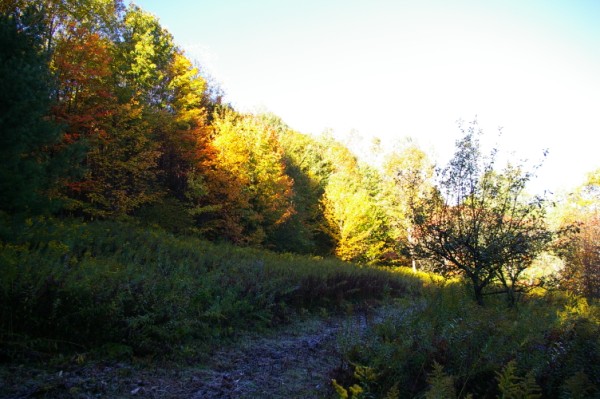

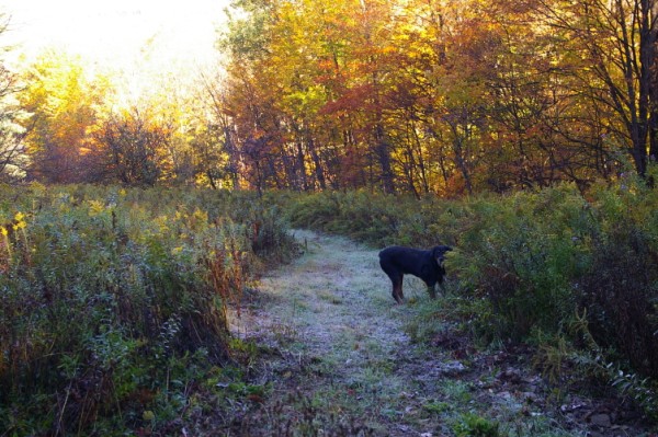

Here are a few swaths I cut with a KK 5 footer. I did it mainly for thruways for the deer. I'd say it wqas 5 to five feet. Like everyone said, "It feels great to reap such Havoc."
