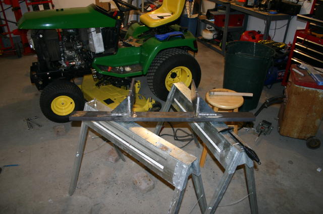

I just started working on the CadPlans Loader 907. I haven't had much experience with metal fabrication, but needed something to move around driveway material, landscape material and snow. This looked like the most cost effective solution for my situation. Good excuse to get out into the garage too. /forums/images/graemlins/grin.gif
Anyone with tips for the beginner please post.
Attached is the first pic of the tractor frame attachment.

Built a 907 3 Yrs ago. Lessons learned: 1, use the same cylinders as are in the kit. Requires less adjusting. 2, Fit the bucket arms as far back towards the front of the tractor as posible. The 907 is set up for many machines that are longer than many of the CUTs, and can position the bucket a little too far forward for some machines. 3, Reinforce the main arms where they attach to the tractor mounts. If you got the MetKit arms they may be cut with too little metal at the main bearing points. 4, After mounting the FEL check and tighten the frame mounting bolts frequently until they settle in.
