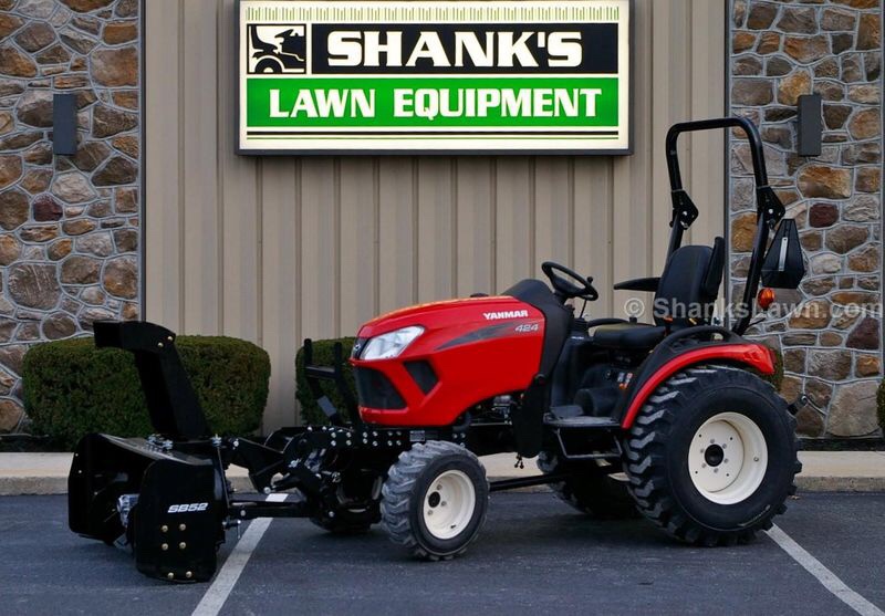

While your cross shopping compare the Yanmar SA424 as well. It has uniquely high ground clearance, 1200lb loader lift capacity, and a mid PTO.
