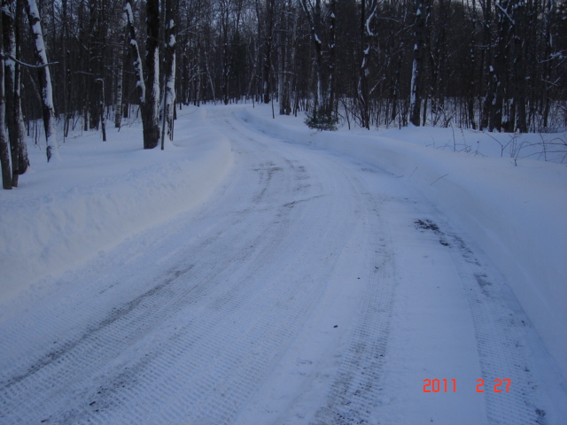

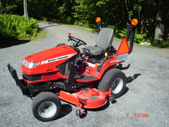

First, my tractor, a SCUT, sounds like it would probably be too small for your use, but I imagine it could do the job. I bought it primarily for snow removal, with plans to do other things as well.
Concerning snow removal: First of all, I don't believe anything beats a plow for speed. But -- plowing will always leave ridges, and eventually you may run out of places to put or push the snow. If you have all kinds of space, a plow is the way to go.
My driveway opens onto a dirt road, and ridges at the top definitely become a liability in the winter, as they obstruct vision. My driveway also tends to get narrower and narrower as winter progresses, if it's done with a plow. I opted for a blower, front-mount, for my little GC. It works extremely well for me. BTW- my driveway is also quite steep, but only about 250' long, plus a large area in front of the garage.
I never have any ridges. It will throw snow well into the woods, even across the road when I clear the top of the driveway and around the mailbox. And this on 23 HP, 18+ at the PTO. Yes, the blower was an expensive option, but I've never regretted it. I would definitely try to save up for it.
I've also found hat the little GC does an excellent job of mowing; I managed to find a used mower deck for it --as an experiment. Now, you couldn't pry it from me.
The 4WD is very helpful, not only for snow removal, but also for mowing on some of my steep hills. It's also amazing where you can fit a tractor this size!
