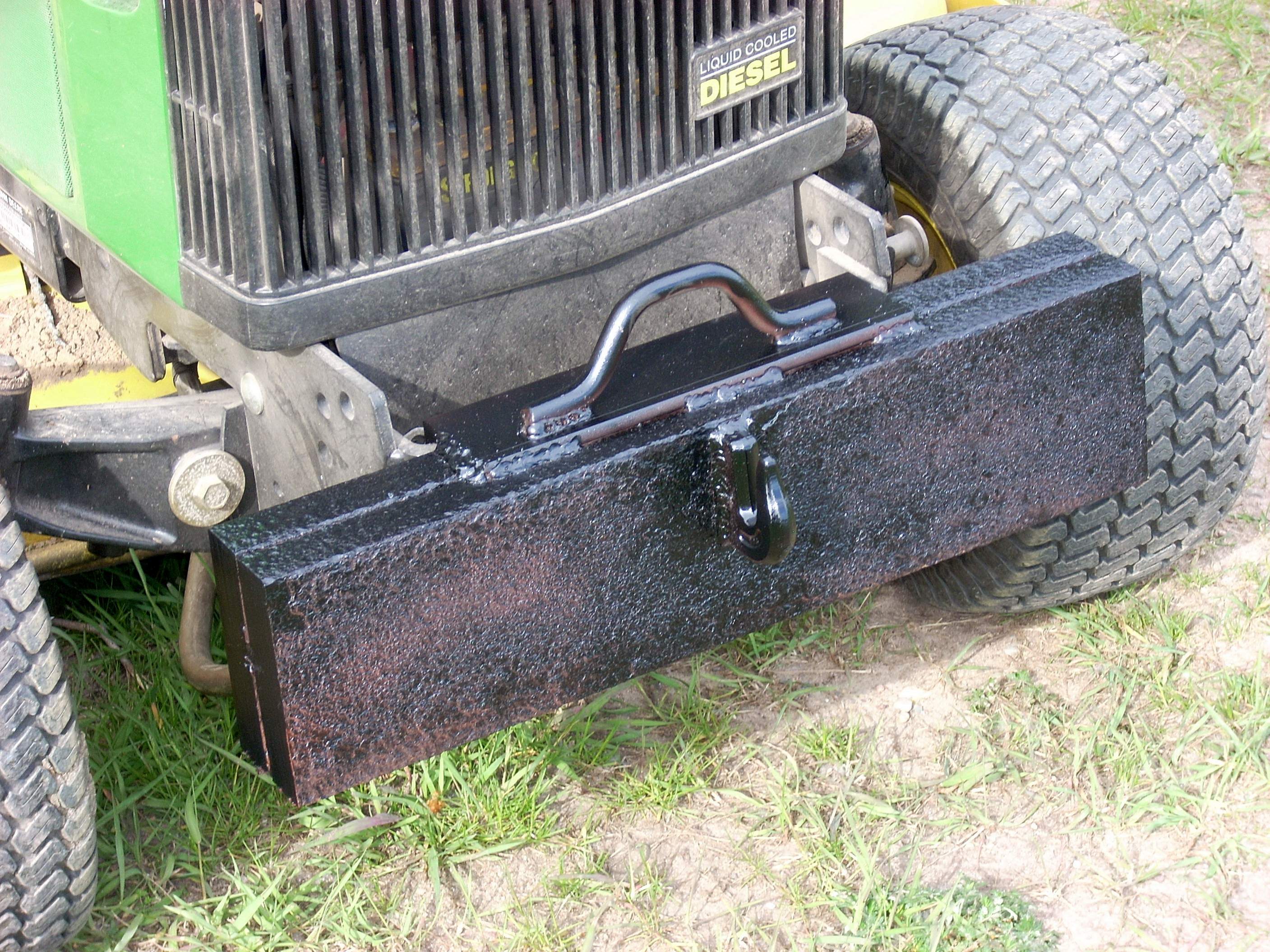

Don't short yourself on attachments. No need for store bought either. An old bedspring is a great levelling drag, so is an old RR tie. I put together an assortment of odds & ends on a 3pt configuration then welded a 2" receiver on top, scrounged one of those 20"x60" trailer hitch cargo trays. Made for an excellent trailer mover, mobile workbench, etc.
Weights can be had cheap. Oil distributor dented 55g barrel $ free. 1000 lb rear weight cost me $10 had it filled at the Redi Mix plant from a returning truck - he was going to wash it out anyway. A bush hog might tip the balance backward so add a front weight. Pix of mine found in a blacksmiths scrap pile 2 2x6 sticks of steel welded together with a piece of angle to hook on the front bumper cost $20 including Wal Mart $0.99 rattle can paint.
