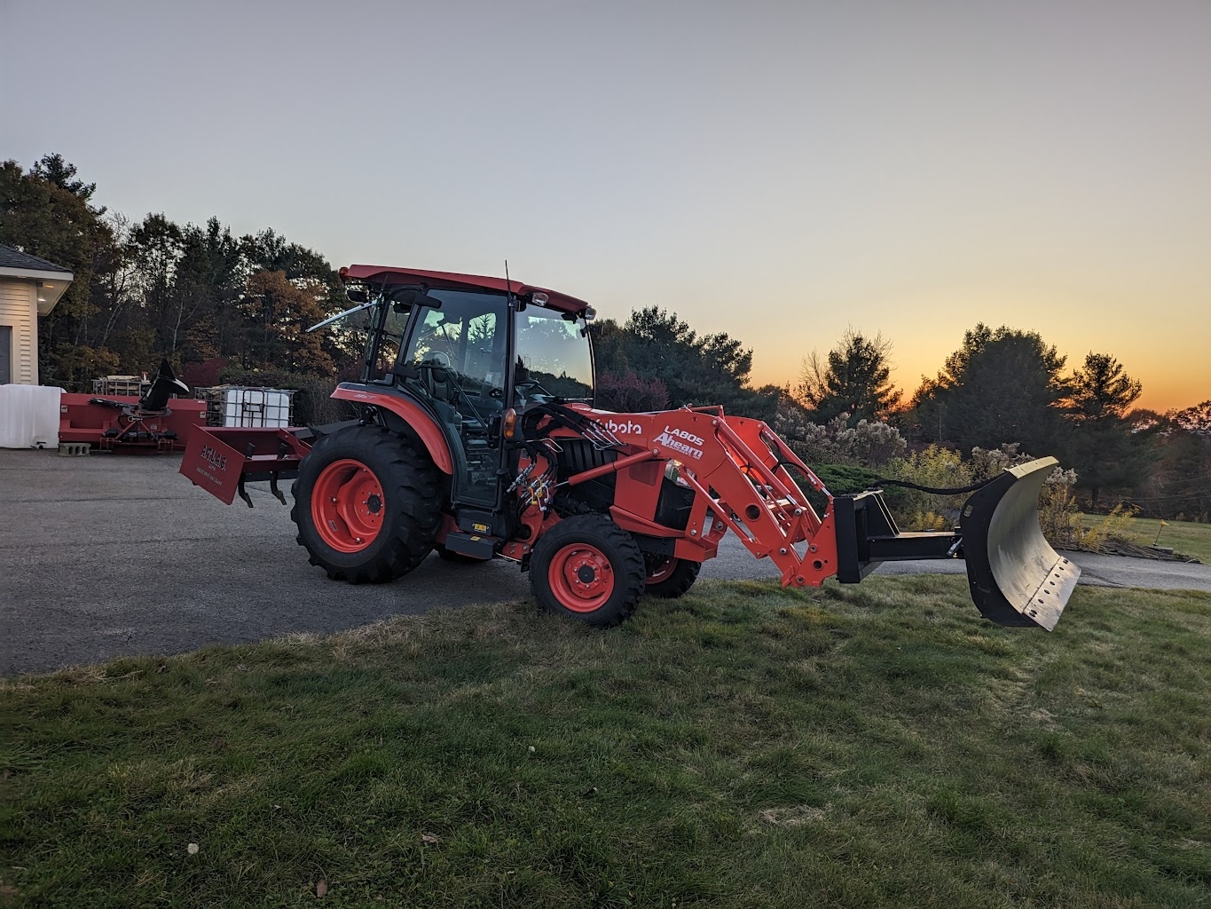

Be gentle, this is my first time plowing with my tractor as well as my first time with a fullsize plow. All noob jokes are expected. :)
I have an L3560HTC that I've added a 7-foot quick-attach plow to. She looks like this:
Yesterday was the first snow and I attempted to use the FEL's "float" mode where the plow is supposed to just glide smoothly over bumps and things like a happy little pillow. Only in my case it just shoved into the driveway and tried to dig up what little asphalt I have left. I have a couple theories as to why but wanted to ask the experts before I do something horribly (yet hilariously) wrong.
My thoughts are that perhaps it's related to the angle of the plow, or the lack of plow shoes, or some combination of the two? I figure that since it has such a large forward protrusion off the SSQA attachment that I just need to angle it more upward than level to make everything happy, but I worry that I'll end up just digging some other part of the plow into my driveway and not notice till it's too late. Does anyone have advice or a tutorial on the proper way to make this all work? So far I've only found generic "how to plow" videos on Youtube.
   / First time plowing with SSQA plow, float mode just digs into the driveway #2
I think your logic is right on the money. ".. perhaps it's related to the angle of the plow, or the lack of plow shoes, or some combination of the two?" Yes, that is the primary adjustments you need to make to avoid gouging your pavement.
You also said "... I figure that since it has such a large forward protrusion off the SSQA attachment that I just need to angle it more upward than level to make everything happy, ..." which is true too. Cut and try making small incremental adjustments as you go and you'll find a sweet spot that gets the job done but causes little/no damage. Probably #1 priority is some kind of skids under the blade to keep it from diggins in. Some of those look like round pads with adjustable height and some spring loaded, etc. You might get away with skids that just barely keep the blade tip from pavement contact.

As you have correctly surmised, your problems are geometry, physics, and lack of experience.
Because of the great distance the plow is ahead of the front axle and the relatively short wheelbase of the tractor, any slight pitching of the tractor translates to big height movements at the blade. I admire RjCorazza and Jchonline's claimed ability to feather their blades to keep them at near constant height. Another bit of geometry: Unless the pin about which the plow rotates is exactly vertical, the blade will not remain exactly horizontal when the plow is angled left or right. This can be advantageous if the road has a crown or camber; experience will teach you. Tipping the pin forward or backward (curl or uncurl) has a similar but smaller effect when the blade is angled.
Because of the blade's small bearing area relative to its weight, skids, "Edge Tamers", or caster wheels are necessary on a floating plow to increase the bearing area and reduce the ground pressure to what the road surface can withstand. Concrete and ice are robust; mud, snow, and loose stone are not.
If the remainder of the snow season does not provide the skills to use the plow in its present configuration there are many threads on this forum on modifying plows to float better.
