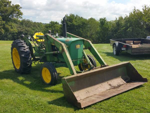

Hey guys, first time posting here and first time tractor owner. I bought a 1970 John Deere 1020 and am loving life! Up till now, I have been stalking you guys by reading as much as I can prior to my purchase and you have been super helpful and want to thank you for that. I plan to use the tractor for driveway maintenance in all seasons. Plowing snow in the winter and shaping the gravel driveway in the spring/summer/fall. I also plan to mow and garden. The previous owner only put 100 hours on in the last 12 years so here is my plan to make sure this thing runs smooth through the winter. Please add to my list of necessary to dos as to prevent potential issues in the future.
  1. Bought engine oil and filter and changing those out. Oil levels were spot on BTW.
  2. Bought Hygard hydraulic oil and filter. Changing those out. Fluid was about 2 gallons low when purchased. Keeping an eye out for any leaks and my have never been checked over the last 12 years.
  3. Purchased a service manual. Will be here Friday.
  4. Purchased a Model 37 loader service manual. Will be here Friday.
  5. OMG there are a ton of grease zerks.
  6. I feel like I should change/clean the air filter but can't find the **** thing.
  7. There is a bowl up front that has a small bit of oil in the bottom and the sticker says to check daily for residue? Well I checked it but there is none. What the heck is that thing?
  8. I assume that power steering works off the hydraulics. Is there a separate drain plug for that?
  9. I also purchased with the tractor a rear blade, rotary mower, and a finish mower. Can you speak to any preventative maintenance that should be performed on those immediately given the limited use?

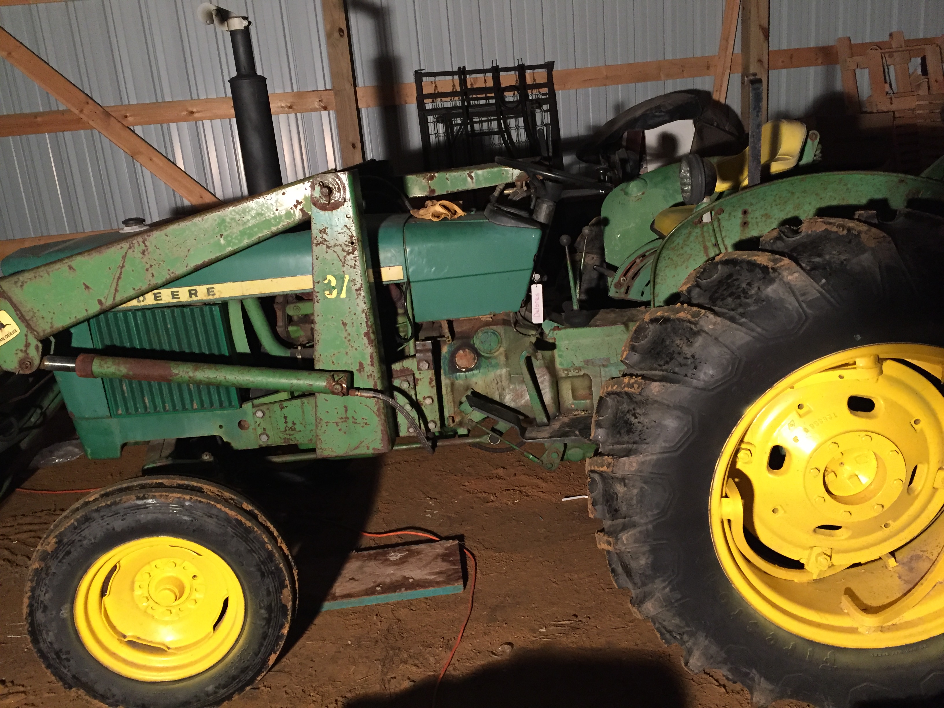

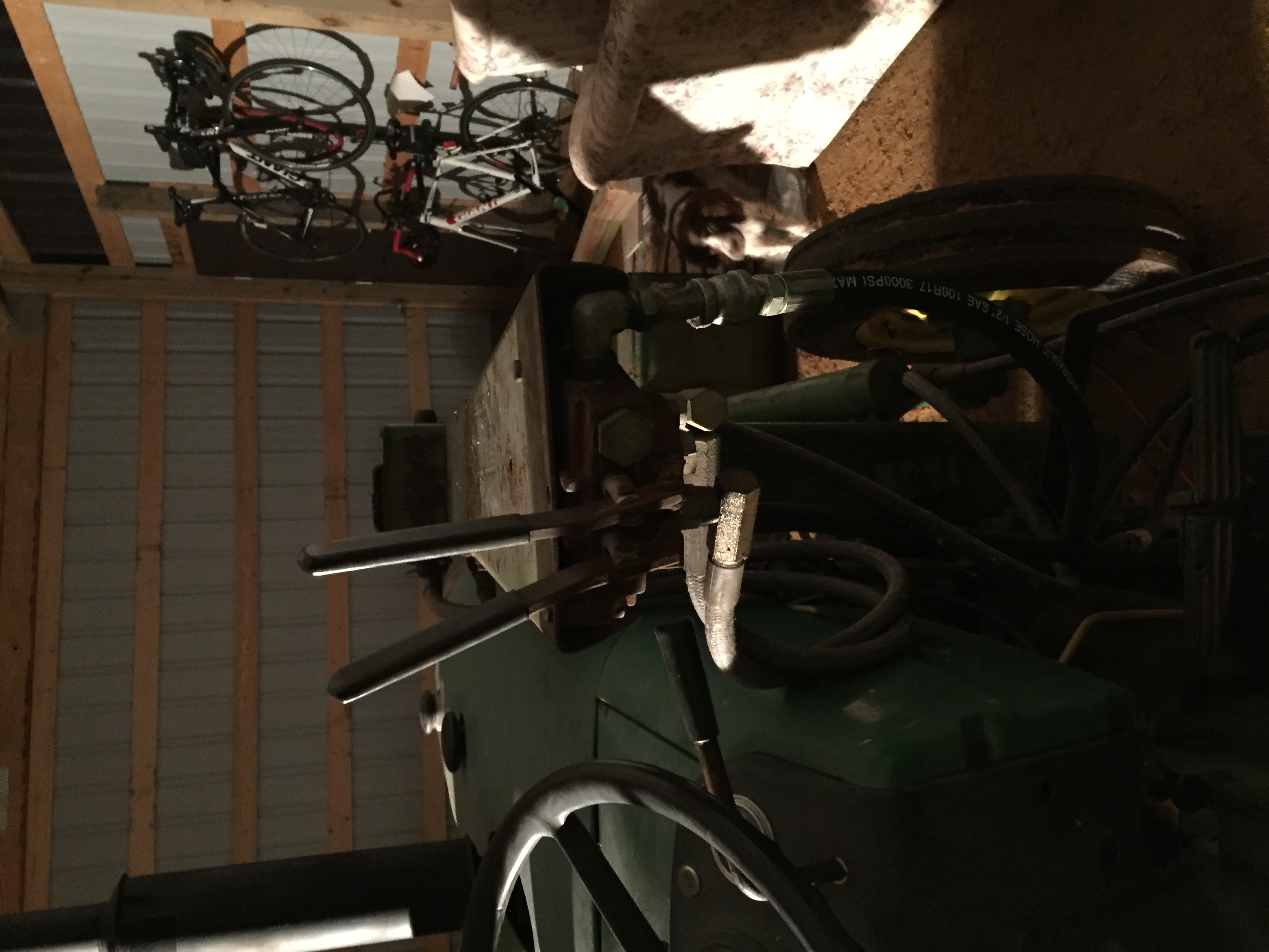

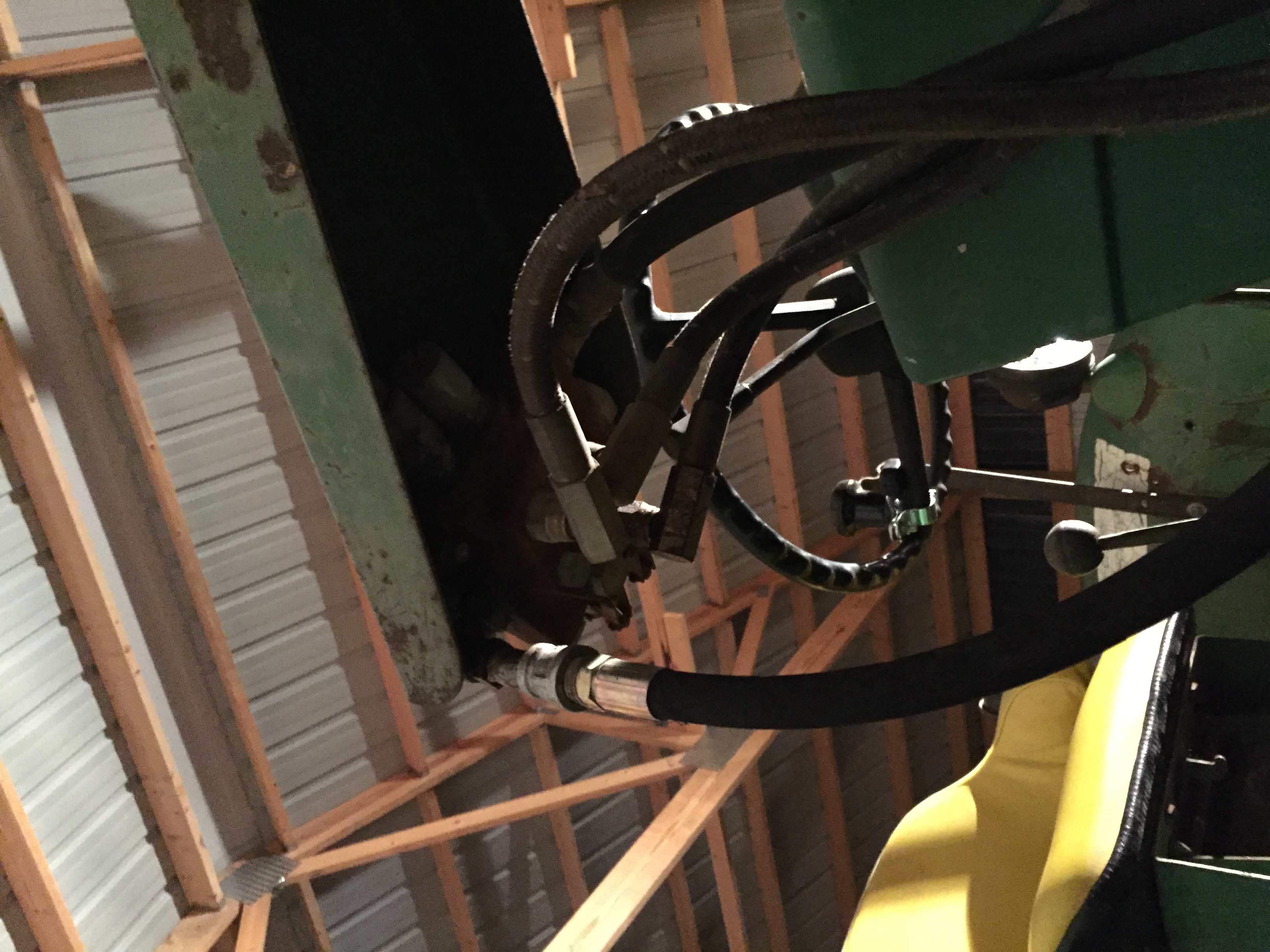

Some photos.

"I feel like I should change/clean the air filter but can't find the **** thing.
There is a bowl up front that has a small bit of oil in the bottom and the sticker says to check daily for residue? Well I checked it but there is none. What the heck is that thing?"
You found what you were looking for. That is your oil bath air cleaner. I thought the later model 1020's had a dry filter element. My 66 has an oil bath cleaner. You may want to check the serial number to verify the model year. Look on tractordata.com for a list. The earlier models have some differences in power steering, hydraulics and such. I saw that you ordered the service manual, a good idea, get an operators manual as well. The service manual will answer most of the questions you have. I really like my 1020, and use it for quite a few tasks around our 20 acre farm. The 37 loader is very handy. I reworked it with new cylinders and hoses, and quick connects for the bucket. Pull 4 pins, disco the hoses, and lets go plow, mow, or bale hay.
