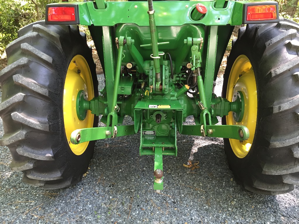

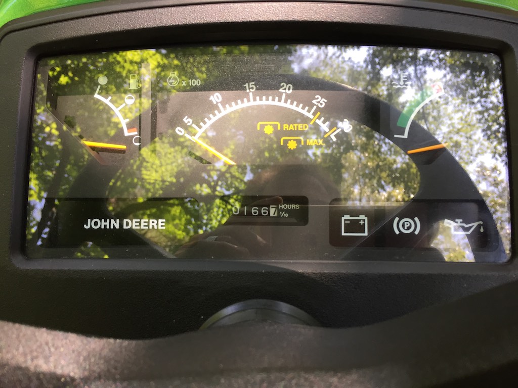

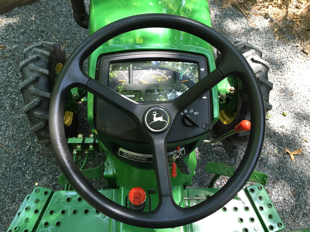

Thanks for all the responses everyone! Here are a few pictures:

By the way, I noticed one interesting quirk about this tractor. For some reason, the steering wheel does not always return to the same position with the wheels centered. It seems to be all over the place. Sometimes with the wheels centered the running deer in the center of the wheel is upside down, sometimes facing right, sometimes left and sometimes it even is centered correctly with the proper orientation. The center emblem is not turning, it is designed to clip in only one way.
On a car, if you turn the wheel left or right and then re-center it, it will always be oriented properly. Not so on this tractor. Any ideas why this happens? I do not believe there is anything broken or amiss, it almost seems it is systemic to the design. Any thoughts?
Thanks again for everyone's help.

Great find Joe, that tractor should do you for many years . I would definitely change all filters and fluids . If there isn't a lot of play in the steering wheel I can't answer that question .

Joe, That steering is by design. I don't know why, but my 4110 does the same thing. Dealer said it was design, so I quit worrying about it.
