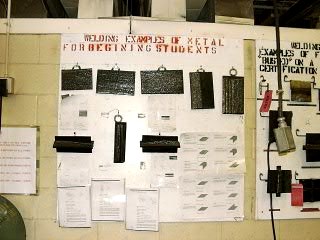

Gary, Our instructor calls this overlaping, "splitting a bead" and he says to watch the 12 o'clock position of the puddle should be right at the center of the bead your overlaping.
He says it's to demonstrate control vs any real practical welding application.
It's fun burning up all those rods on these 3/8" plates.
gary

Last night I help weld some 16" knee braces for the instructors project.
We used 1" sq tubing cut at 45degrees and welded some flat 1/4" flat plate to the 45's. We used the 7018 3/32" rod right out of the oven. I've only welded a few passes in class with this rod and have found it not at easy as the 1/8" 7014 rod.
A bear to start the arc, and it's so flimsy, it's hard to keep it in the puddle at times.
Anyway, we tacked 2 oppisite corners of the tubing/plate and then ran beads along the edges. I only had on place where I long arc'ed it and gouged the sq tubing with a small hole. Knocked the slag off and made another quick pass along that part of the weld and filled in the hole nicely.
Well the 3 sides were pretty easy compared to the 45 angle "under" the tubing. It was real hard to get the arc started, because the sides of the plate and the tubing came together before the rod could touch the metal. We had to angle the rod more tward the 1/4" plate since it was the thicker material and didn't want to burn holes in the tubing. The first pass I made I went too fast and didn't get good penitration.
Tried again and it came out great.
The instructor gave us a B+-A- for the cutting and welding which I agreeed with and knew after I finished that the next time I could do a better job, but for the first time doing anything like this, I'm happy with how it came out. Learned a lot, and that's why I took this class!!/w3tcompact/icons/smile.gif

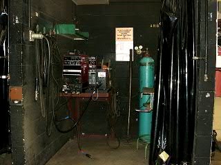

I'm curious as to what level of eye protection you're using and what the consensus in your class is. That's been quite a topic of conversation during the breaks at our class. I have an adjustable helmet but still haven't found the perfect mix of enough protection and good visibility of the work.
Truth be told, one of the biggest problems I have is wearing bifocals (OK, needing bifocals). The instructor warned a couple of us "seasoned" students that would be a problem and it is. Unfortunately, in my case, I couldn't find the bench without them. /w3tcompact/icons/smile.gif

I'm not so concerned with flipping the helmet up and down as I am with the proper darkness setting for the job. Any thoughts on that when using 7013 rod?
My owner's manual lists 11-13 but I was hoping for some real world insights as even the 11 setting makes it difficult for me to see what I'm doing. The flip side, of course, is that I don't want to endanger my sight in any way just for this, either.
/ First welding class tonight #50
Pretty much a matter of age and eyesight. When I was in my 20s, I welded with a #13 plate in the helmet, that was a long time before MIG or Gold filter plates.
When the gold plates came out, I dropped back to a #12, and loved it. I also have a different hood for MIG with a lighter plate because MIG produces less light than a 3/16 rod or 1/8 rod.
"Difficult to see what I'm doing" is more a function of lack of experience than it is a function of plate shade. Truth be told, once you've burned a few hundred pounds of rod, you don't really watch as close as you did starting out, cause you don't need to. At your stage in the welding process, I recommend you spend a little more time pre-planning the weld and positioning yourself to make the weld, and stick with the darkest filter plate you can see the deposit thru.
If you wear glasses, a big part of your problem could be the focal length of the glasses isn't the right distance for welding. I've watched a few [censored] good weldors go half nuts adjusting to new glasses/
