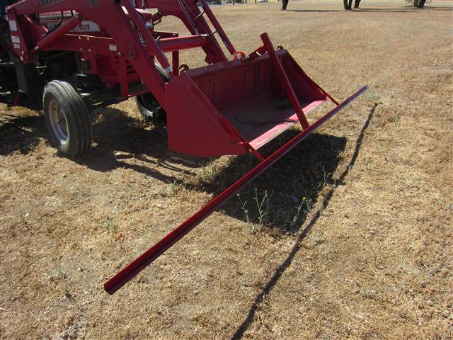

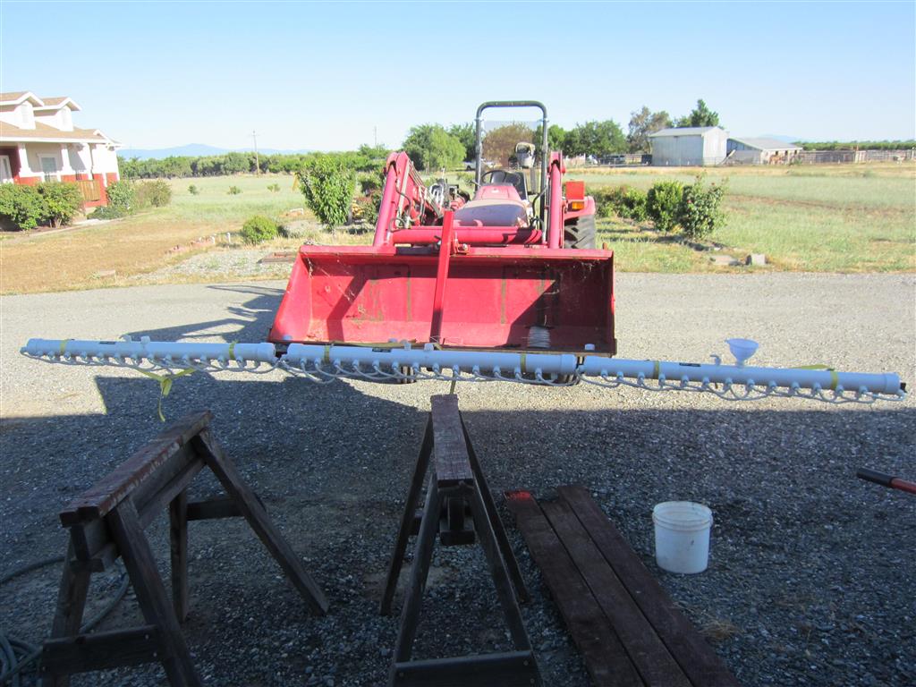

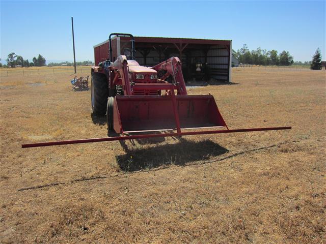

If the weeds stand taller than the good stuff, you can use a wick applicator (aka weed wiper) to apply your favorite herbicide.
Here's what I rigged up on the FEL of my Mahindra 5525 tractor.
The modules are 5-ft long and cost about $110.
I use 3 modules.
You can buy them at AgriSupply.com
Good luck
