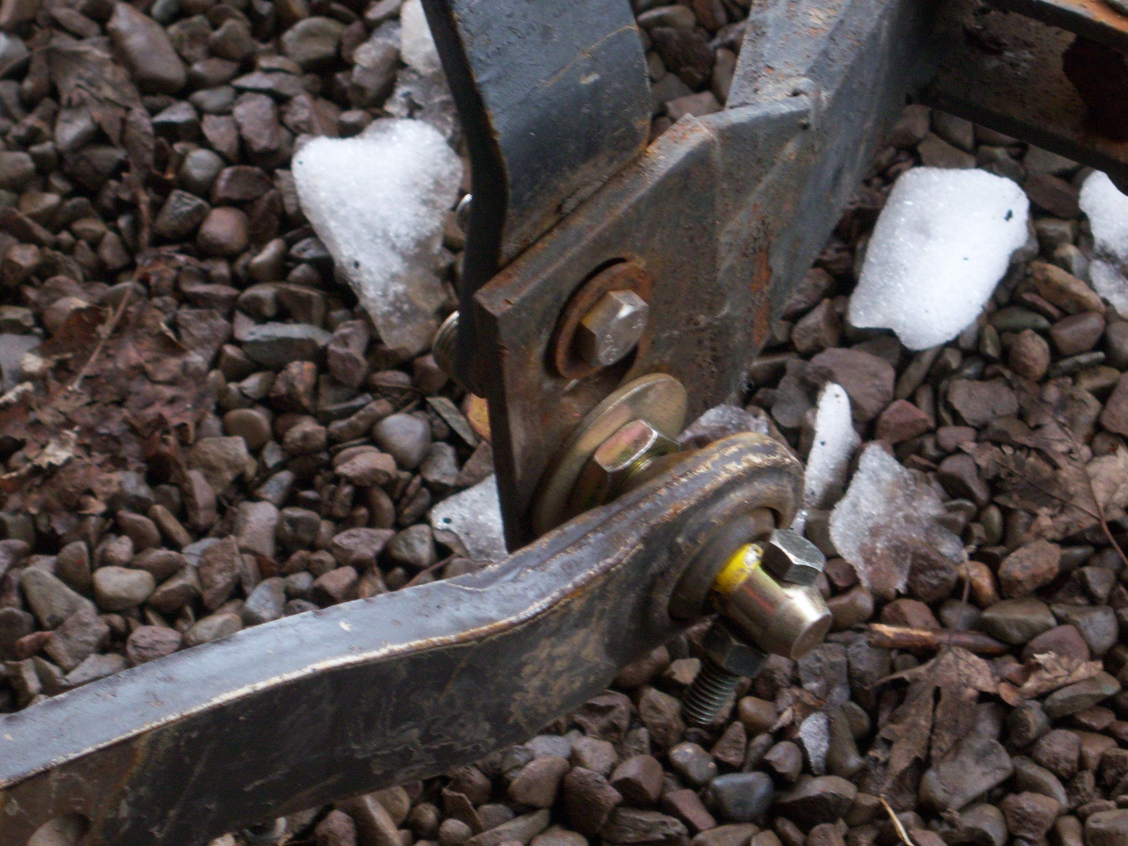

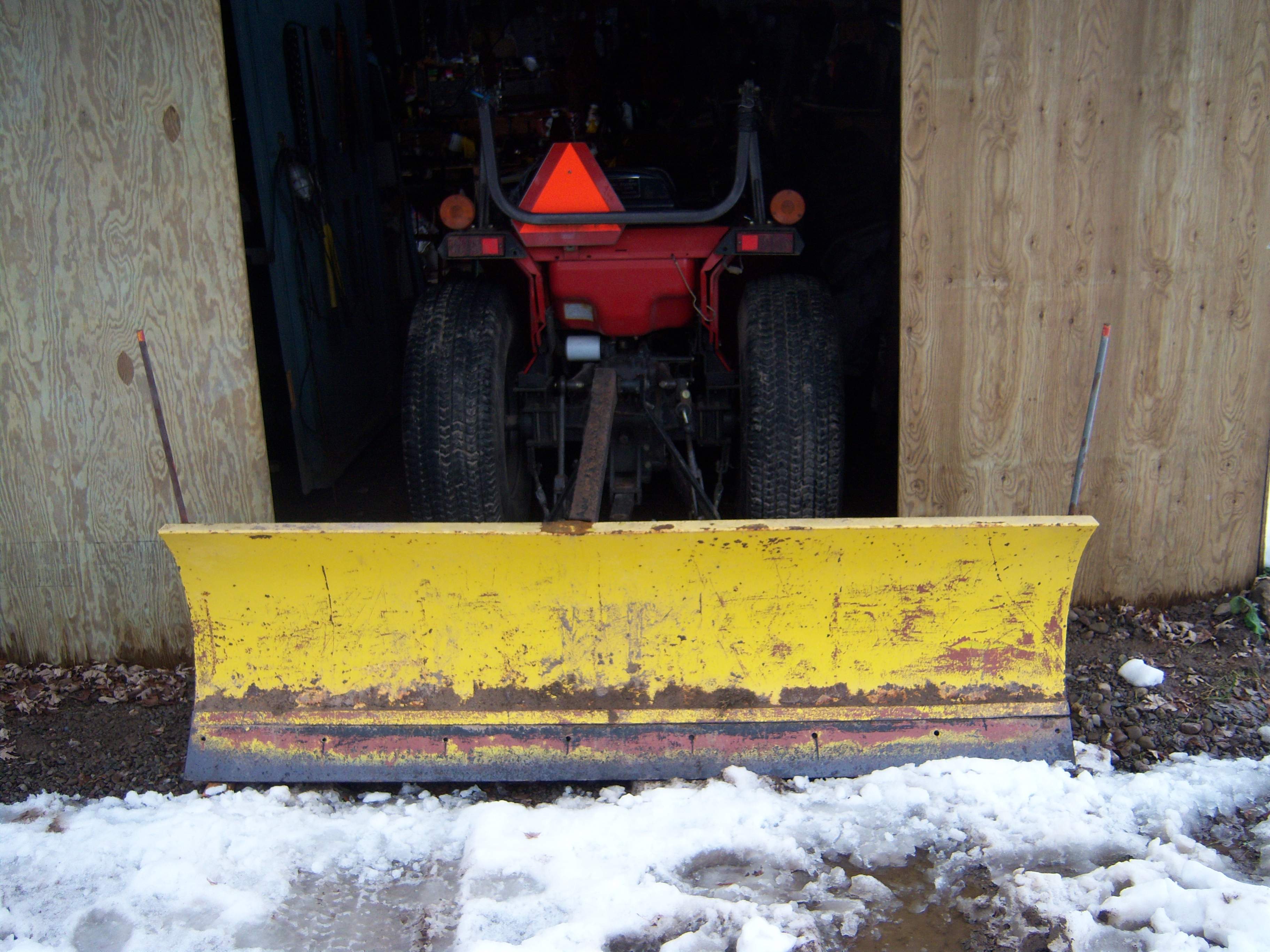

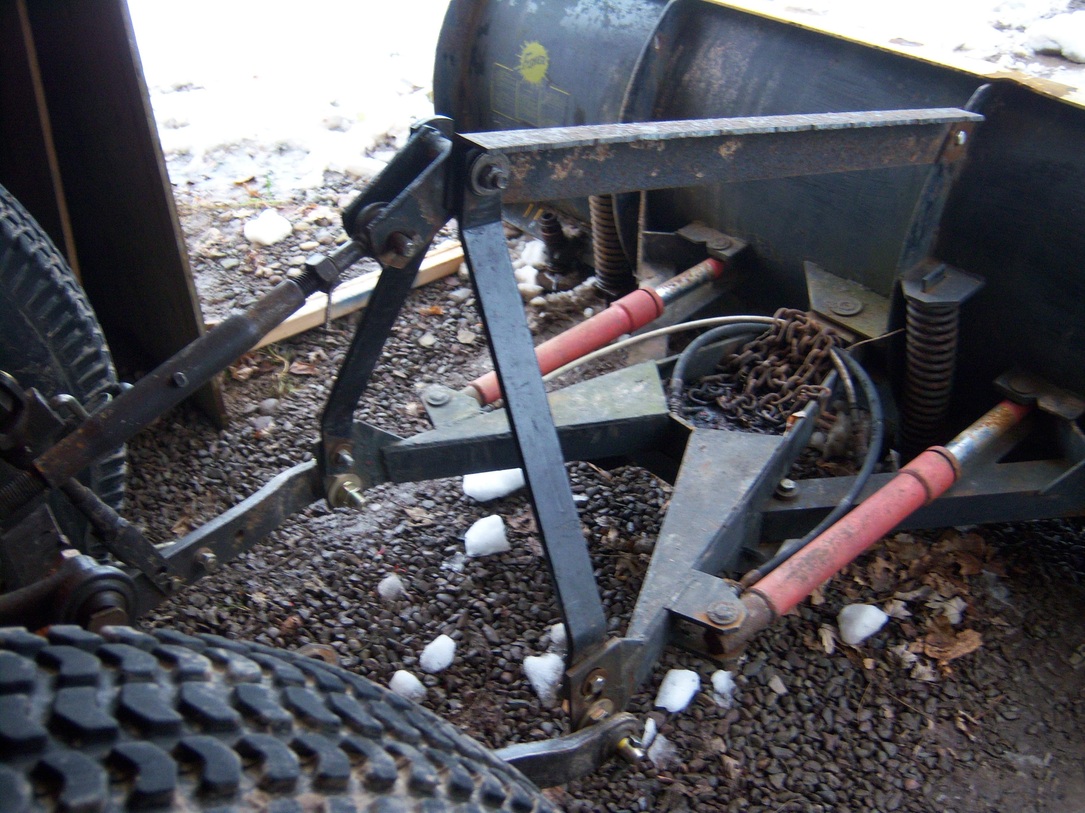

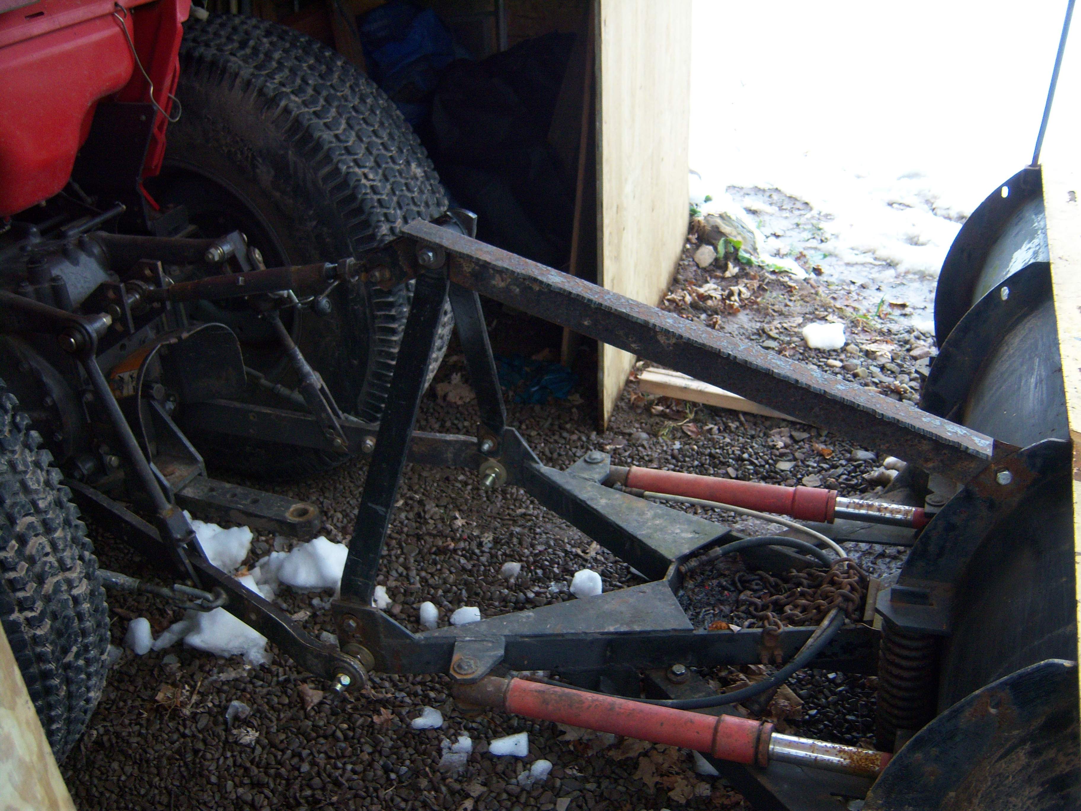

I am posting this for my father. He wanted to show how he connected his fisher plow from his old truck and connected to the 3 pt hitch. Basically he used his front frame from the bush hog in the winter time and mounted on the fisher plow a frame with pins from TSC and added angle iron to toplink and plow.

Nice fit!!
Does he have any concern about bending the arms on the 3pt?
They are made for pulling and not much pushing. Perhaps a cross bar to help keep them straight.
Phil
   / Fisher plow on 1250
My dad says no. He been doing it this way for 3 years. He doesnt ram banks, no hill or objects to hit with either. The spring trip blade on the bottom of fishers plow also takes some of the force if it ever gets caught on anything. He also has shoes on it so there less of chance of cutting edge to catch on anything. :)
