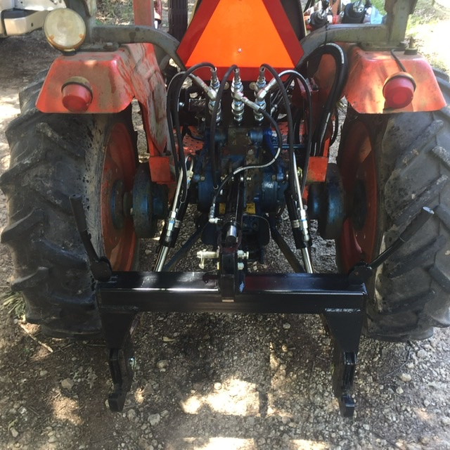

On my Fit Rite tilt cylinders I used pilot operated check valves. They never leak down no matter how I adjust them.

Looks like you have dual tilt cylinders. Just out of curiosity, why? I had assumed that a single tilt cylinder was sufficient.
   / FitRite Top and Tilt on MX6000 - My Experience #16
I used two so I could adjust the height for different implements. It makes using the quick hitch easier swapping between the finish mower and bush hog. Before I got the two cylinders I had to drop the finish mower on blocks so the quick hitch could get low enough. Now I can lower it plenty low to just back under.
On the bush hog it was so tall the 3pt lever was right in the curve and my stop would not hold. I can just adjust the Cylinders higher and keep the lever in a spot the stop works well.
